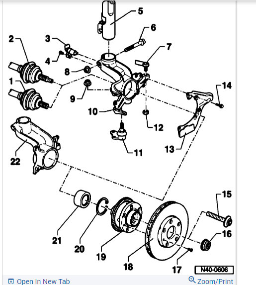

Changed the wheel hub assembly and wheel bearing. Put the car back together and now there is a obnoxious clunk when I turn either direction at a slow speed and there is zero brakes. Pedal goes straight to the floor.
