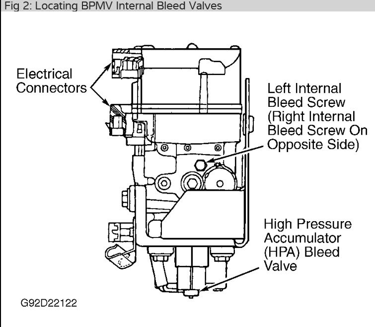

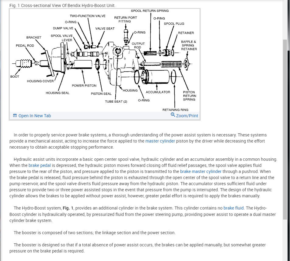

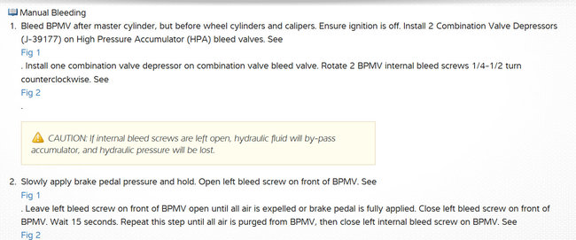

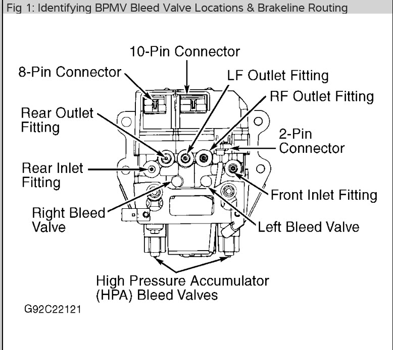

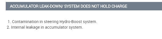

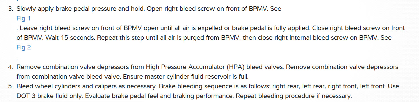

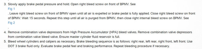

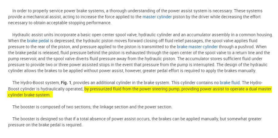

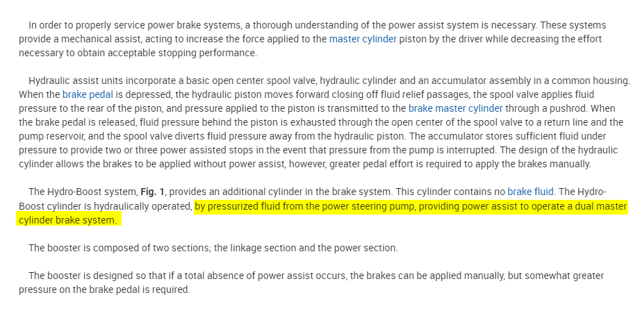

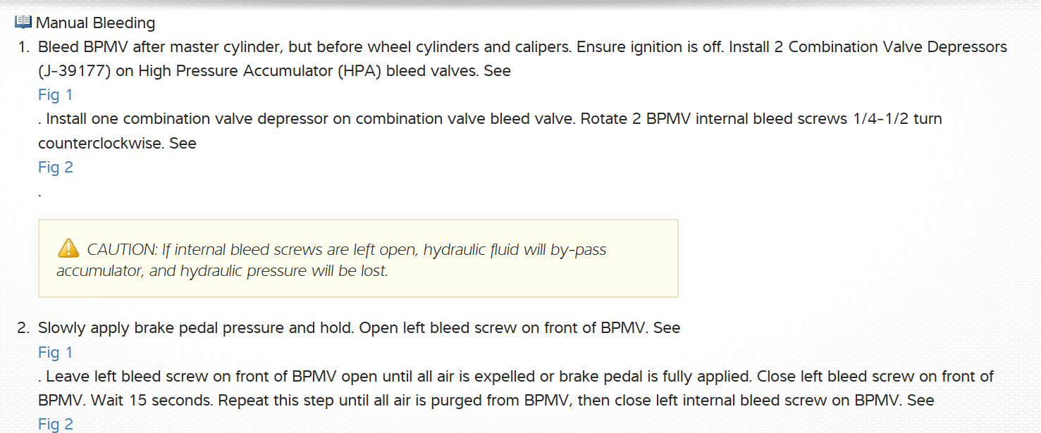

after repeated bleeding i appear to have a solid pedal when the engine is not running but when i start the engine the pedal goes directly to the floor with very little pressure. there are no brake lights on and the lights on the dash go off as usual when the key is turned on.
