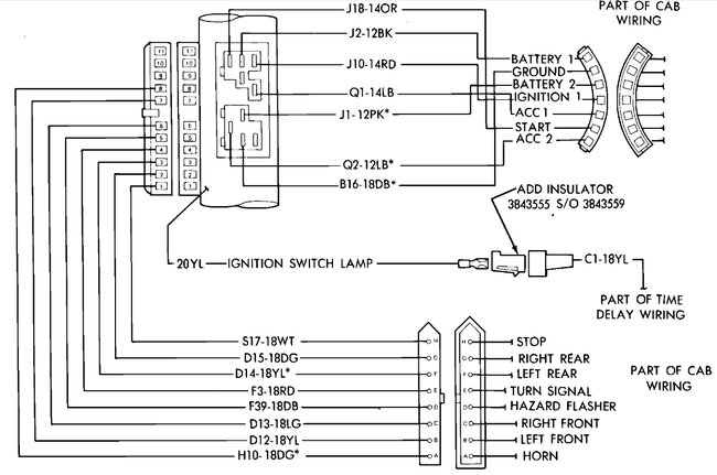

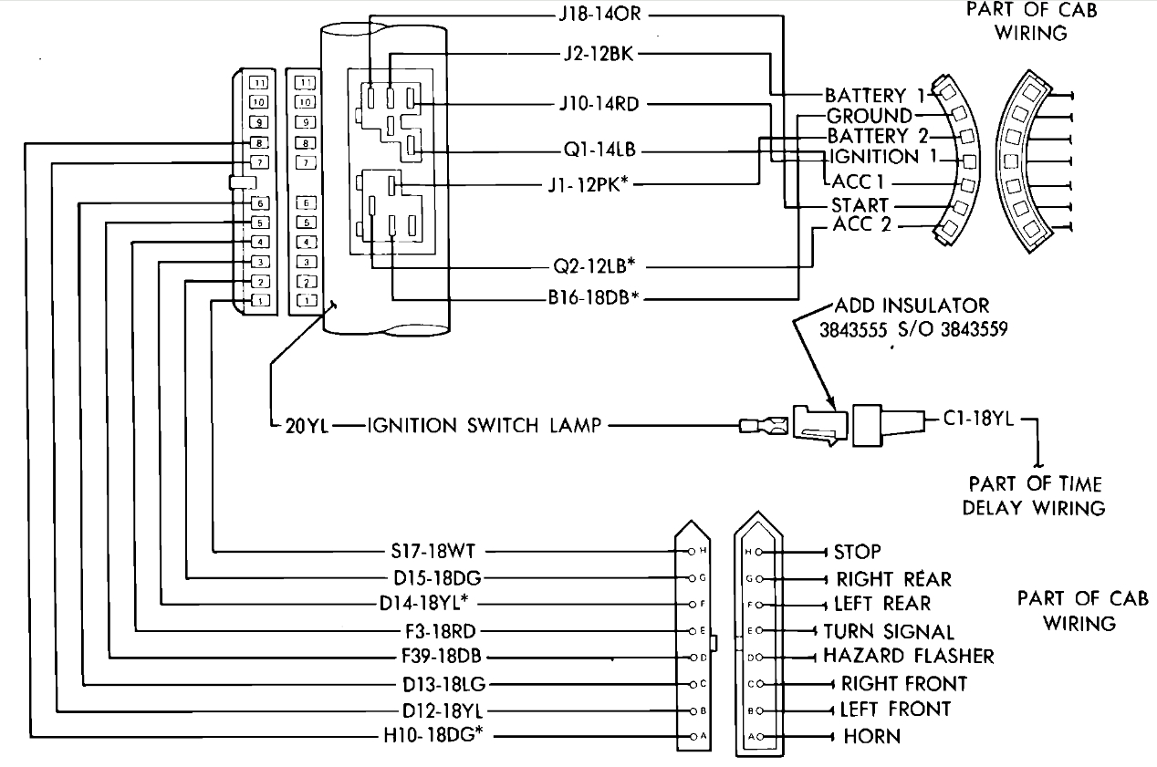

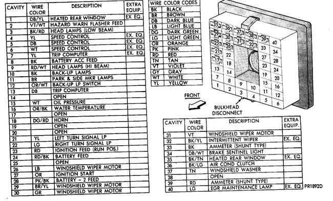

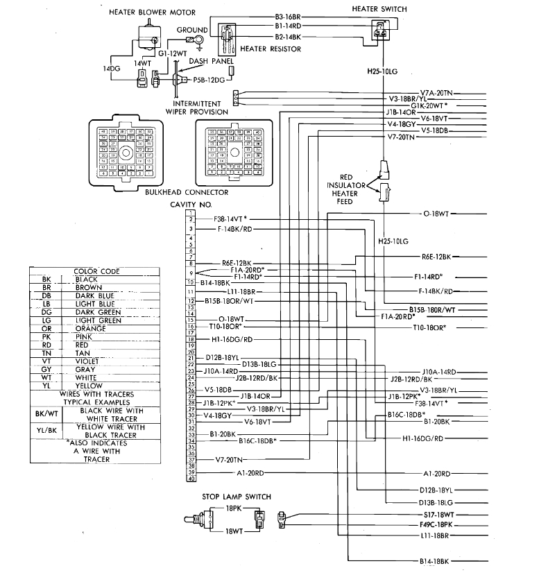

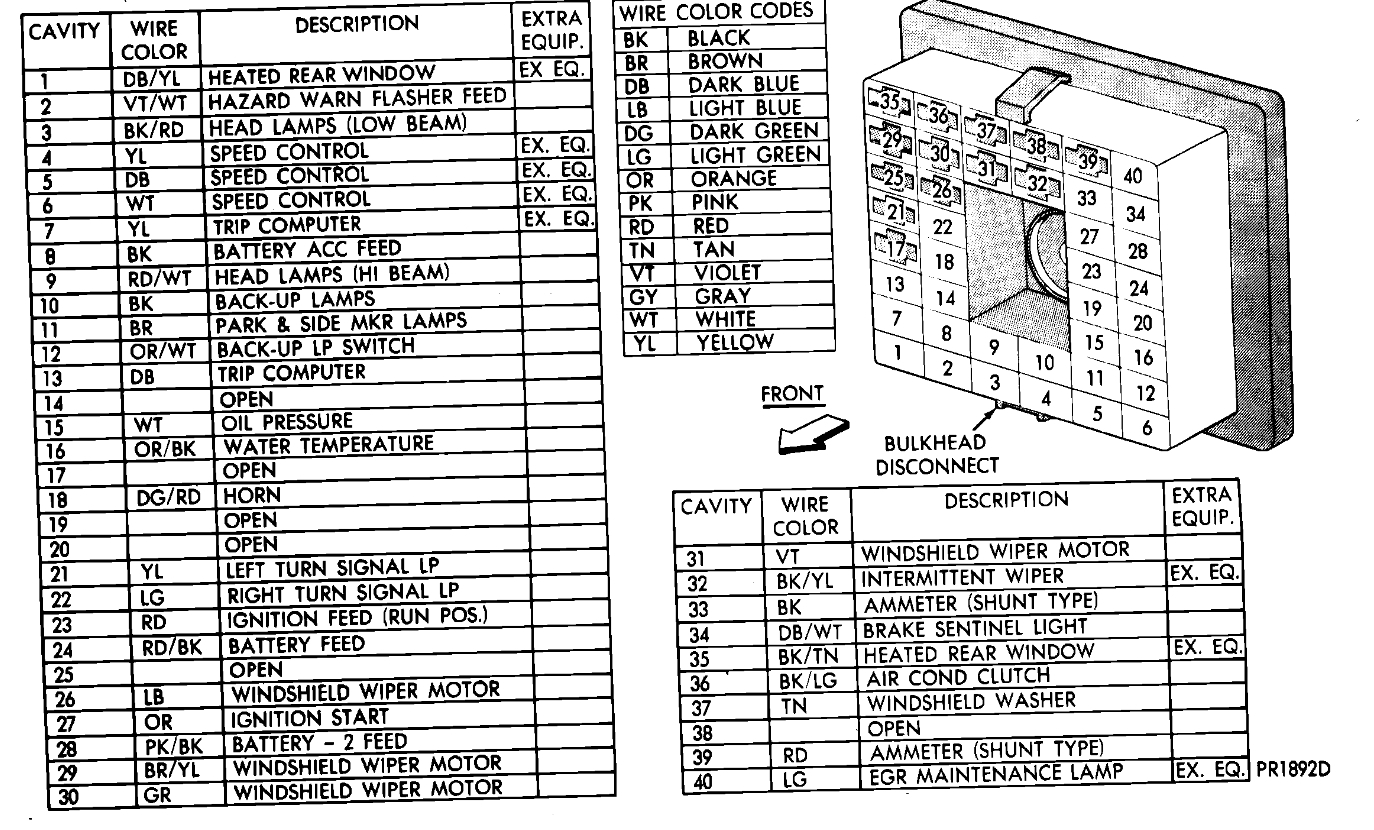

Brake lights, turn signals and hazard lights are not working, can I get a color copy of the wiring diagram and fuse box diagram?
1984 DODGE VAN
180,000 MILES • 5.2L • V8 • 2WD • AUTOMATIC
CHRIS DAKE
  • 27 POSTS
Just installed a new steering column in the vehicle listed above b250 5.2l with a 31I: I need a clear color copy of the wiring diagram and fuse box diagram for my girlfriend's van that doesn't have working brake lights turn signals or hazard lights. All other lights work except the one light inside the cab because the dome lights are removed. Before we got the van.
Jul 30, 2024 at 7:27 AM
We have some wiring diagrams for you, to get more you will need to get a manual from Amazon for $35 sorry.
