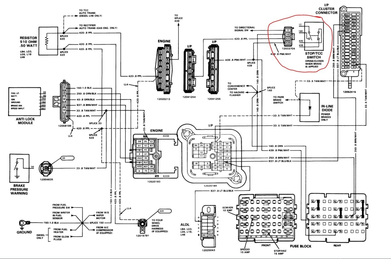

Good evening,
Did you verify the power to the switch? You should have one wire with power all the time. When you push the pedal, it should light up another wire.
I attached the wiring diagram for you for the stoplights.
This sounds like a wiring issue to the rear lamps.

Yes, I have verified power at the switch. I’m thinking it’s in the wiring somewhere in the back of the truck. I’m just trying to check with someone who has more experience in this area in case I missed something. I really appreciate your help though. I have never messed with wiring before so that helps a lot. I do know the truck has the 3 way plug for a trailer could an issue be in that?
