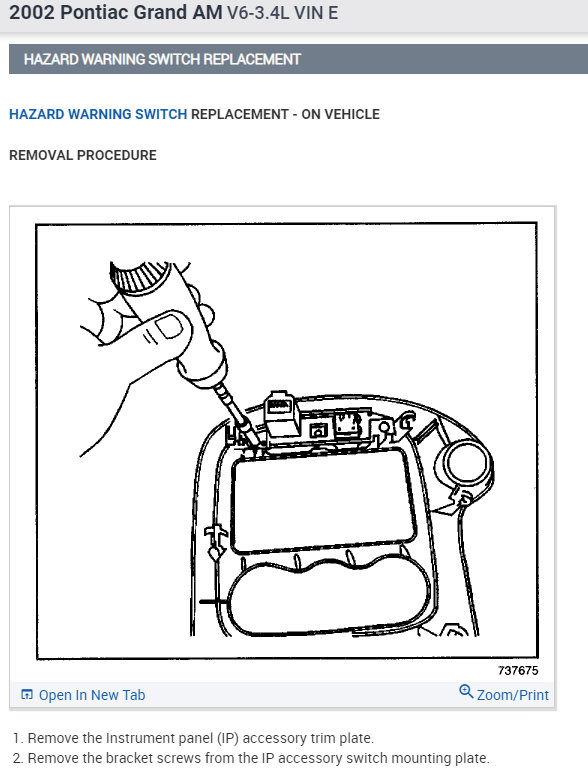

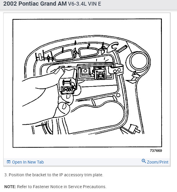

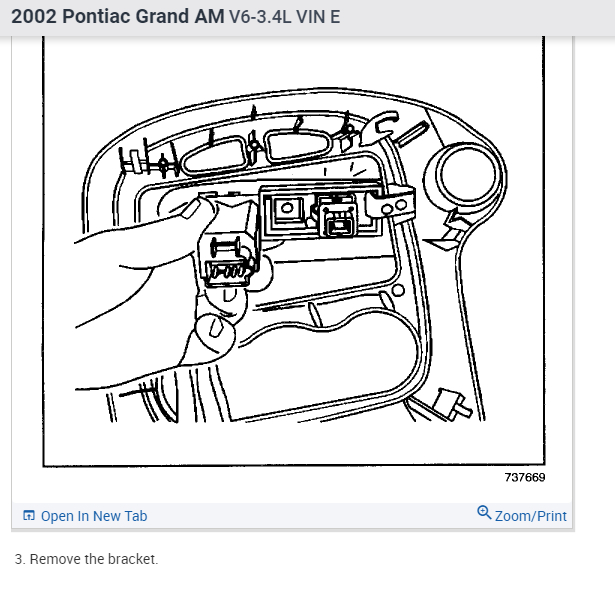

I've had this car for nearly a year and have not had turn signals or hazards (inside or outside) this whole time. after a significant amount of research i believe it to be the multifunctioncombination switch in the steering column.
