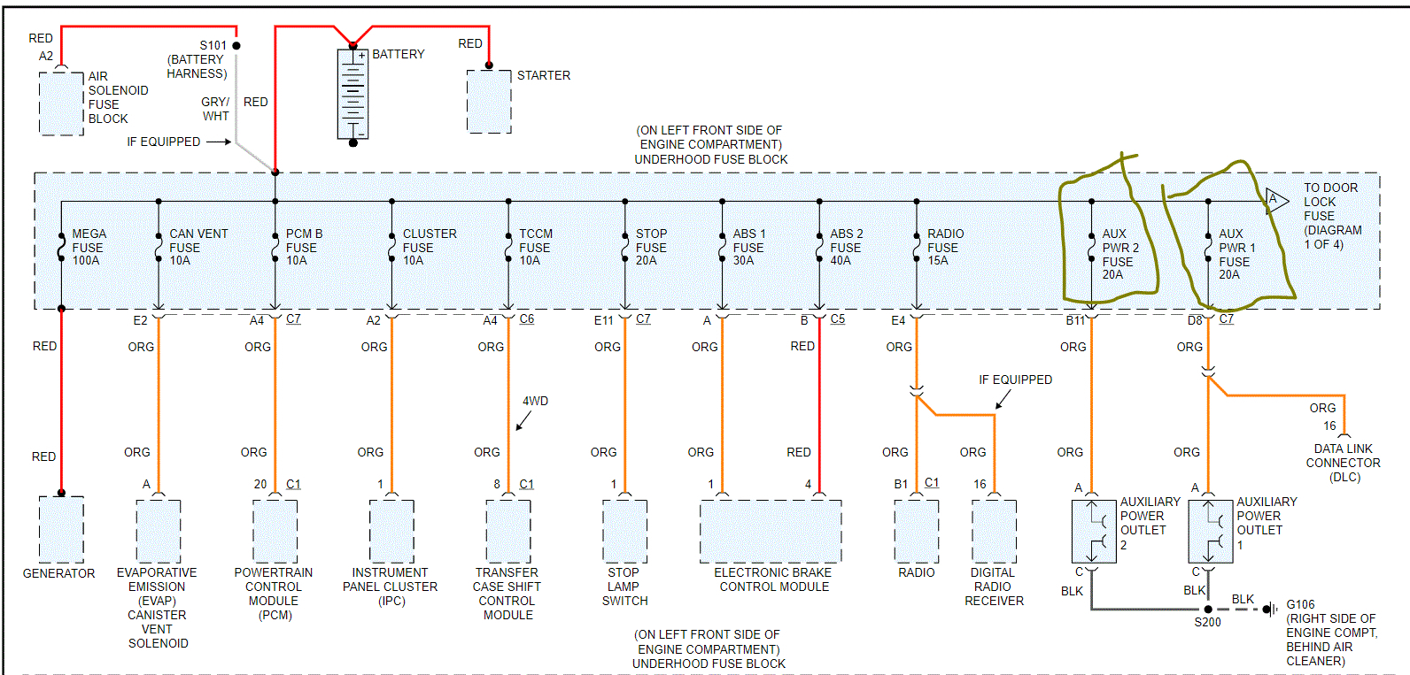

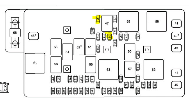

I lost aux power to the hole aux. all 4 fuses are good but no power to any of the 4 fuses. all wiring is good. All fuses in fuse box are all good and working good just no power to cig liter and did used a light tester on all fuses and the 4 around the aux1 don't work at all can't figure it out. As to why there is no power to them 4 I'm stumped everything around and underneath the truck looks good all grounds appear to be grounded good. what else can I look for?
