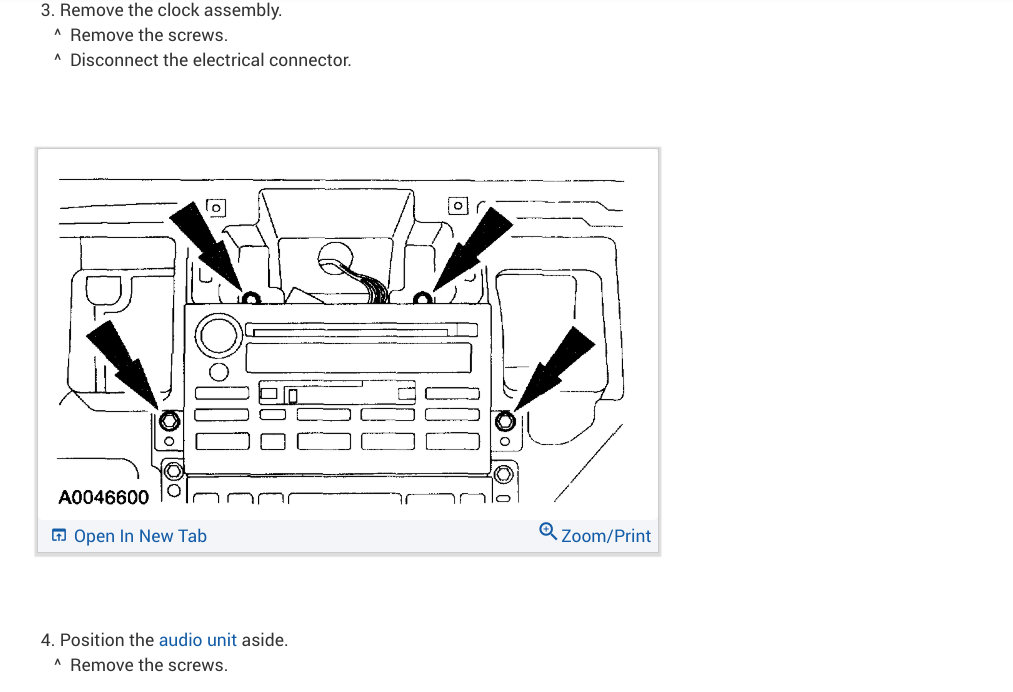

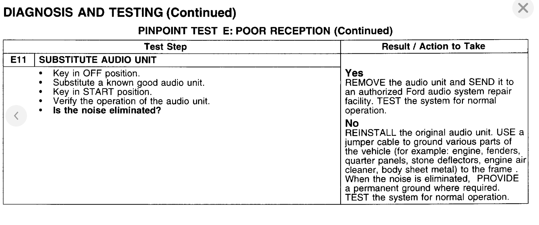

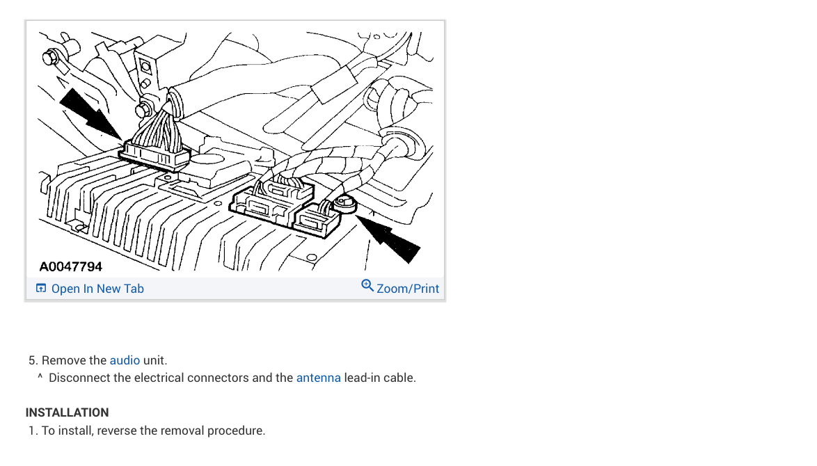

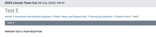

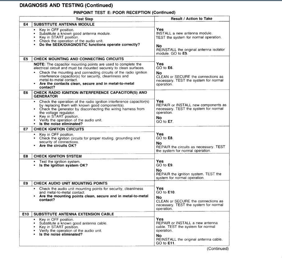

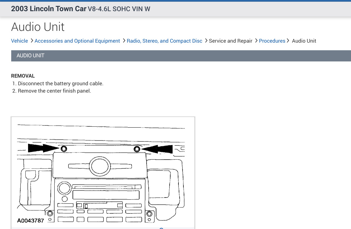

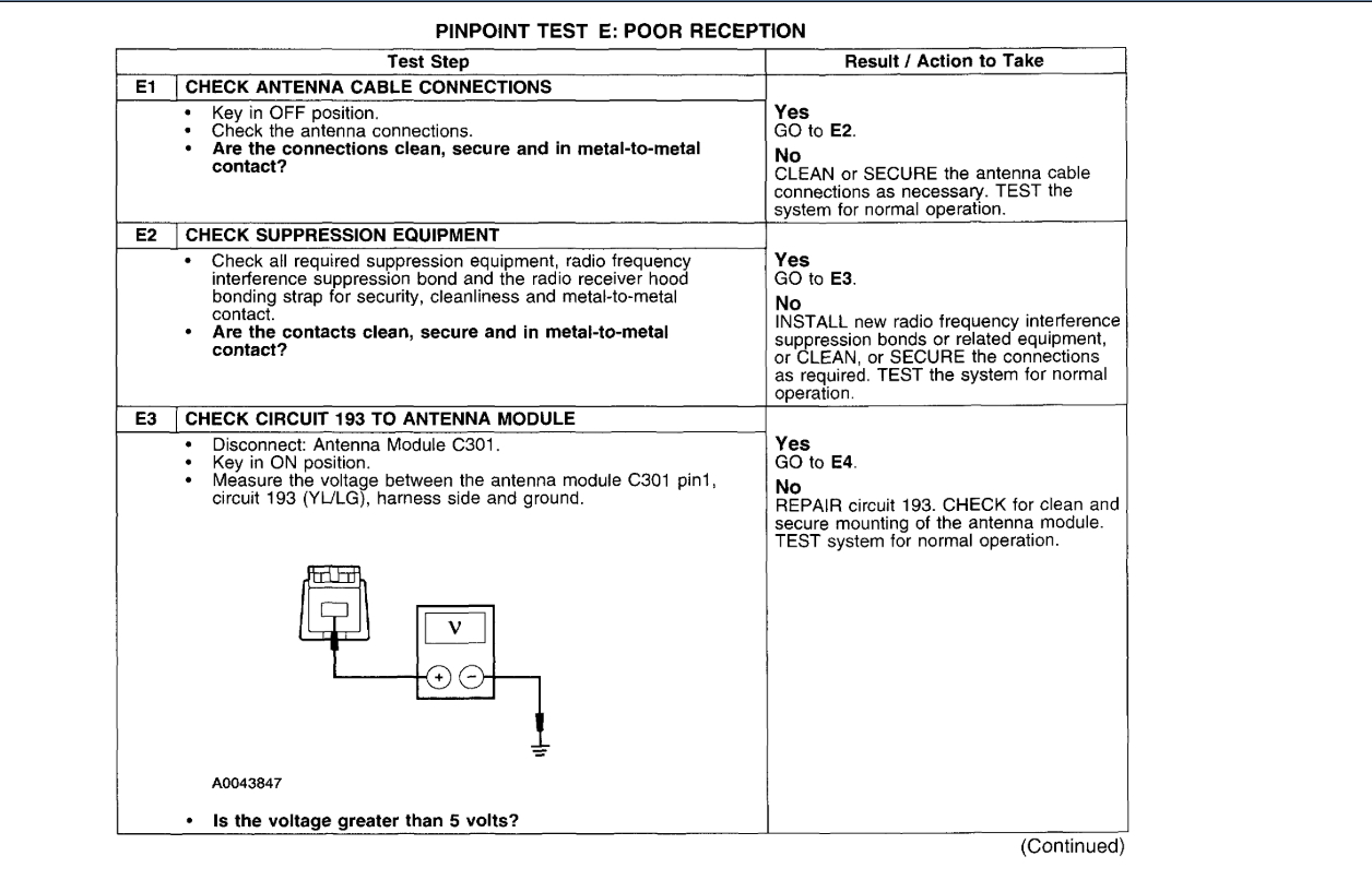

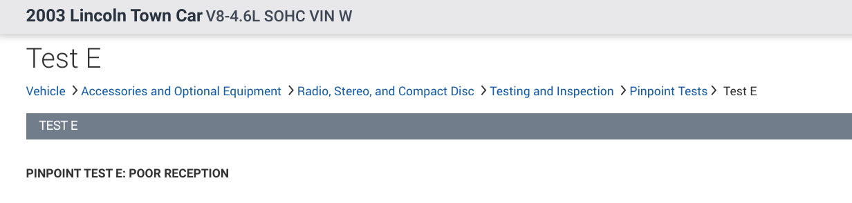

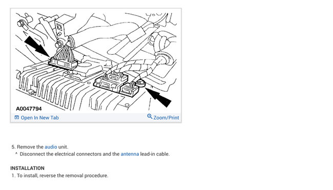

This is probably a case of the antenna coming unplugged from the back of the stereo. In the diagrams down below I have included Pinpoint Test E and the instructions for the removal and installation of your vehicle's stereo. Please use Pinpoint Test E only if the antennae was not unplugged from the back of the stereo. You will need to take the stereo out to check the antennae connection in the back. Please go through these guides and get back to us with what you find out.
Thanks,
Alex
