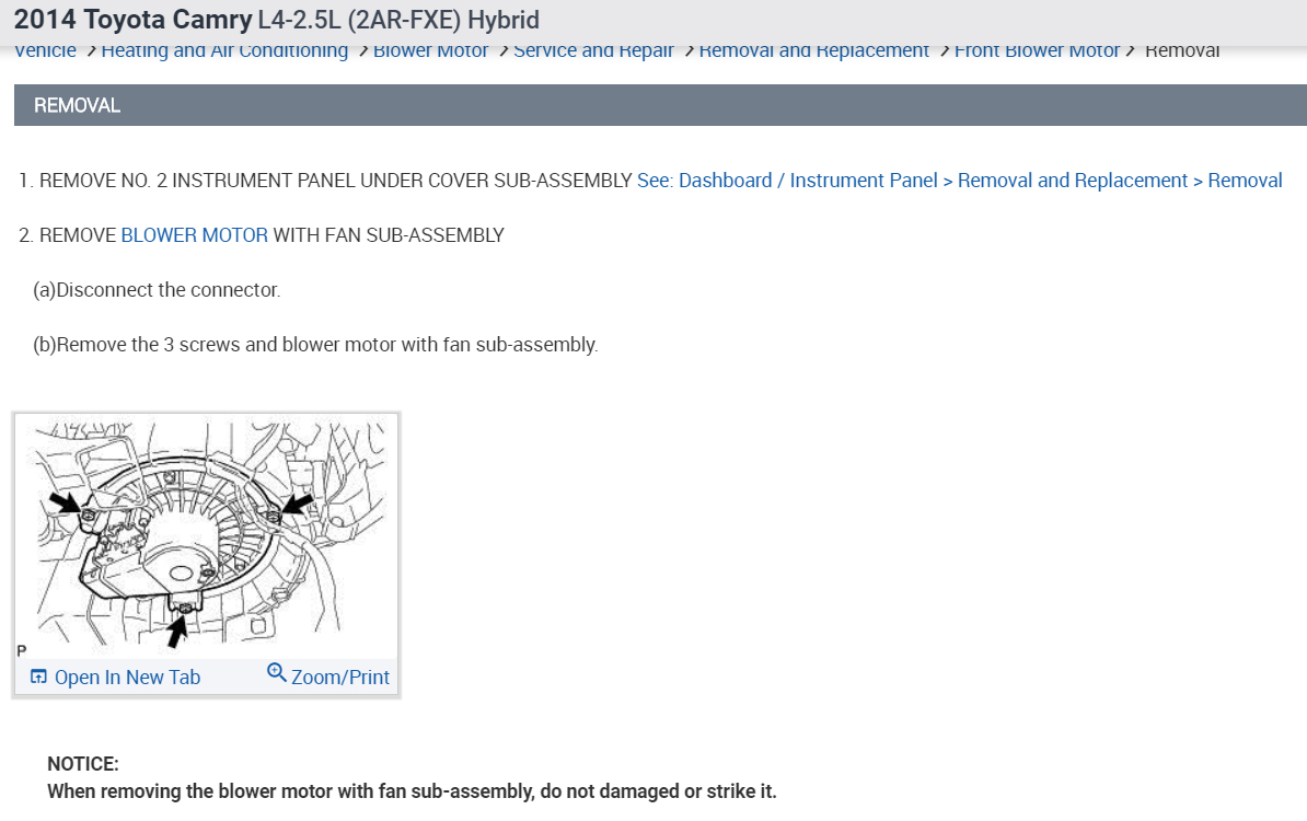

Problem source ; a screw fall in air vent gears that prevented the door to works accurately
Problem solution :
-removed the housing containing the wheel path (and by the way removed the falled screw ) to do this you have to unscrew 3 screws ... 2 at the bottom (you have to use a very short screwdriver for 1 of these) .....1 screw at the top (activate the air recirculation; it open a door and you will be able to access the screw passing through the left side of the opened box)
-replaced the housing containing the wheel path ; didn’t install completely .... just enough to see how the wheel worked and did it many times to find the appropriate way ...... tied screws when worked correctly
Not easy .... no space.... no professional tools.... anyway it’s done....
