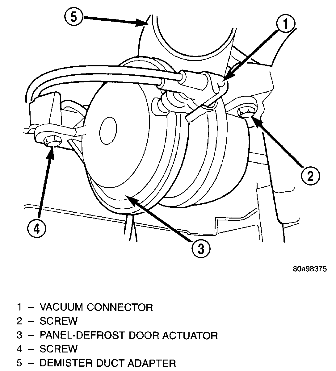

Here are the directions. The attached pic correlates with the directions. Note: This component is under the dash/approximate center.
______________________________________________
Panel-Defrost Door Actuator
1. Disconnect and isolate the battery negative cable.
2. Remove the instrument panel assembly from the vehicle. Refer to Instrument Panel Assembly in the Removal and Installation Instrument Panel Systems for the procedures.
3. Unplug the vacuum harness connector from the panel-defrost door actuator.
4. Remove the two screws that secure the panel-defrost door actuator to the heater-A/C housing.
5. Rotate the panel-defrost door actuator clockwise about one-quarter turn to disengage the hooked end of the actuator link from the hole on the end of the panel-defrost door lever.
6. Remove the panel-defrost door actuator from the heater-A/C housing.
7. Reverse the removal procedures to install. Tighten the panel-defrost door actuator mounting screws to 2.2 Nm (20 in. lbs.).
