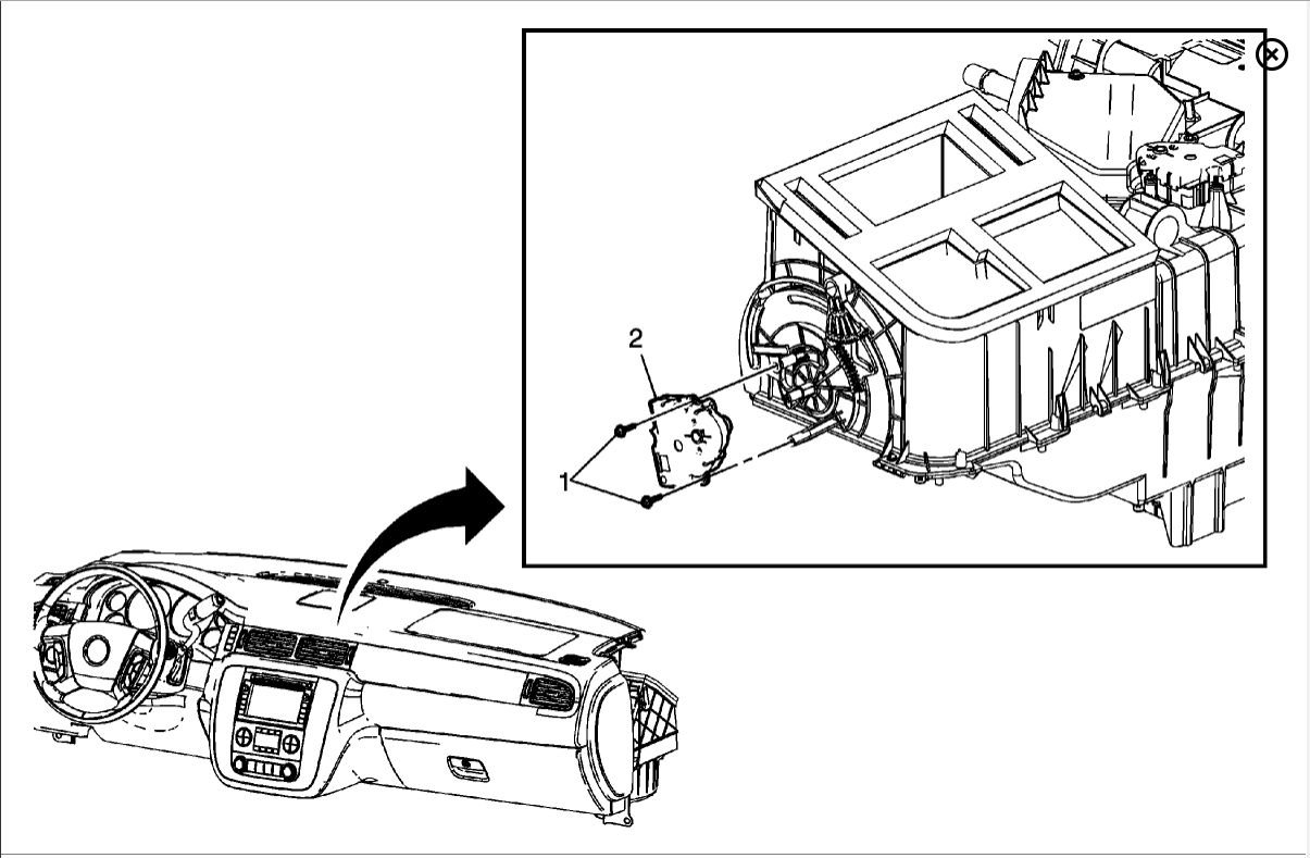

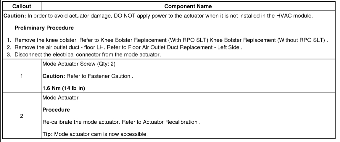

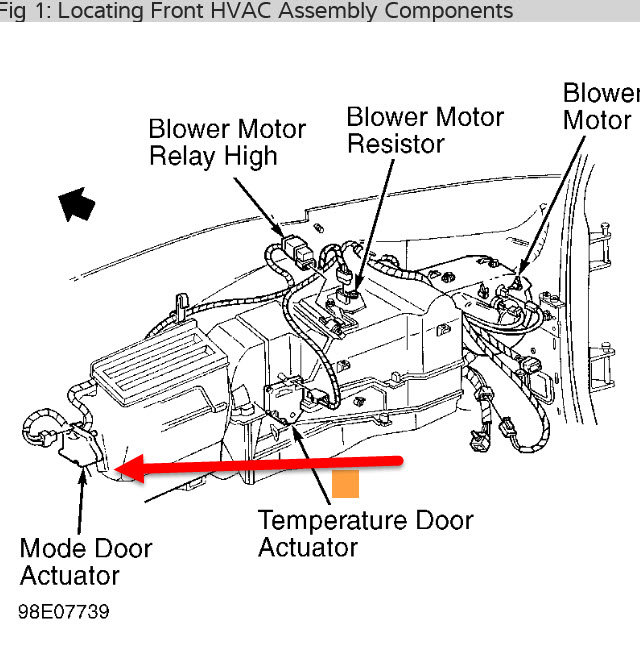

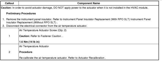

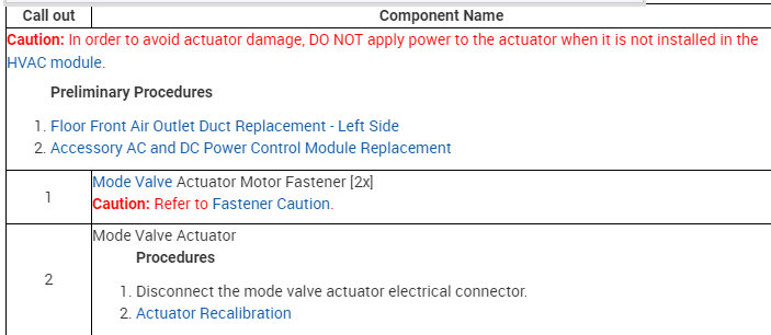

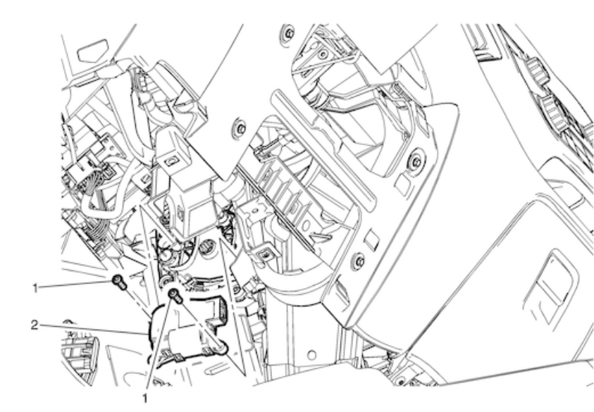

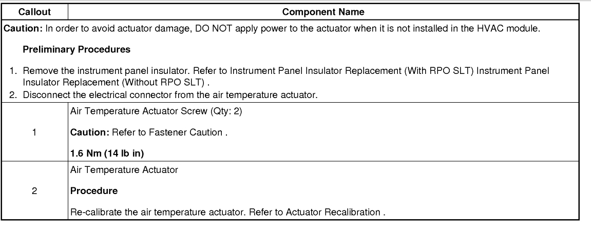

It sounds like you are having an issue with the mode blend door actuator. It's a small electric motor that opens/closes to move air flow throughout the proper air ducts. Here is a tutorial to show what's involved for replacement:
I've attached step-by-step pictures below including its location for your specific Chevrolet truck.You will need a GM scanner to calibrate the actuator after replacement.Hope this helps and thanks for using 2CarPros.
Check out the diagrams (Below). Let us know what happens and please upload pictures or videos of the problem.

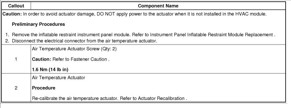

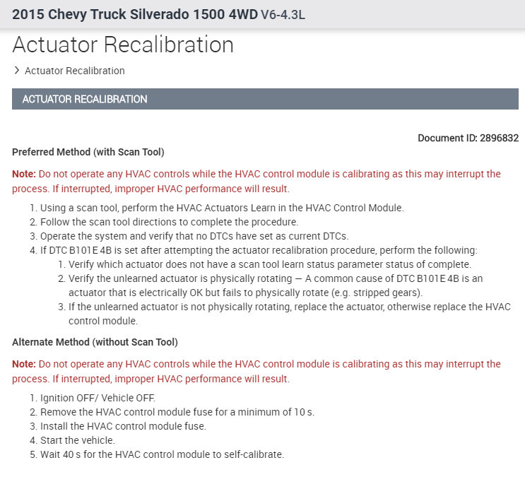

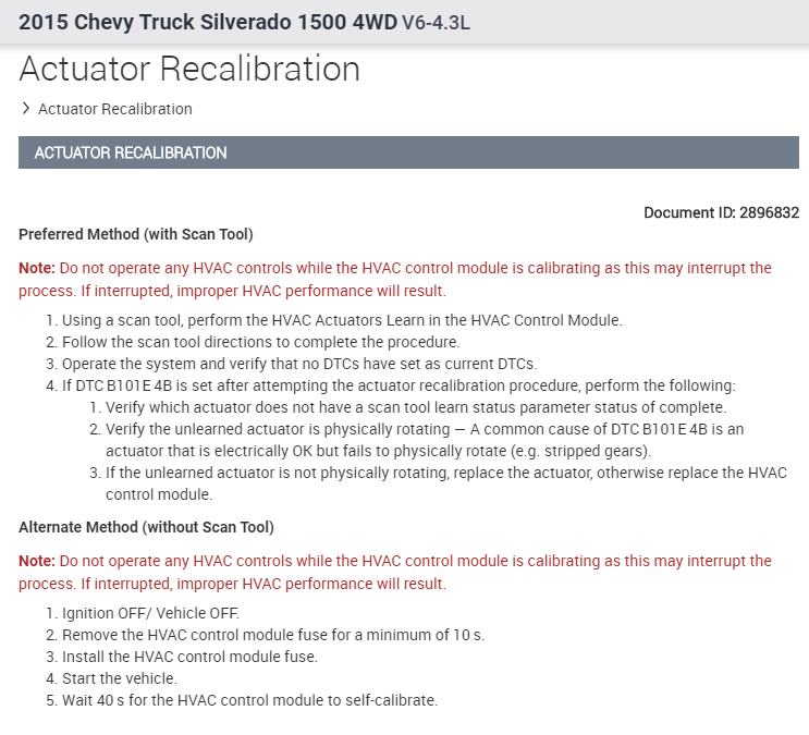

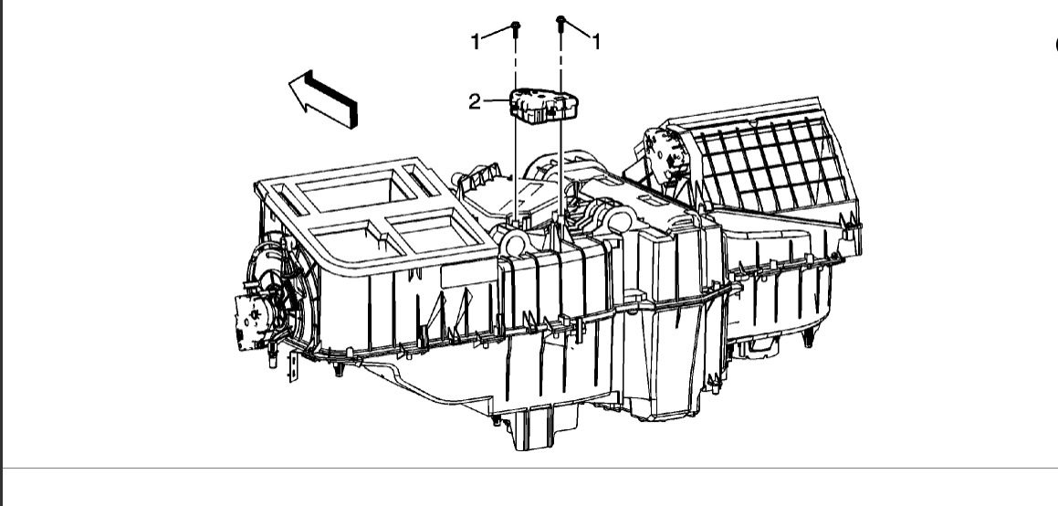

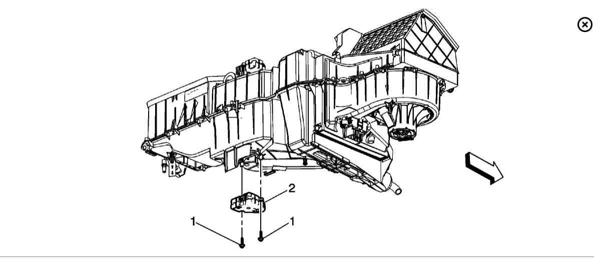

Okay it sounds like you have a mode blend door actuator that is going out. Here is a guide that should show you what you are in for when doing the job.
Here is what it will be like in your car (below)
The diagrams are Mode, Right then Left air blend door actuators. After replacing the actuator the system may need to relearn which can be done by removing the HVAC fuse for 15 minutes.
Please let us know what you find.

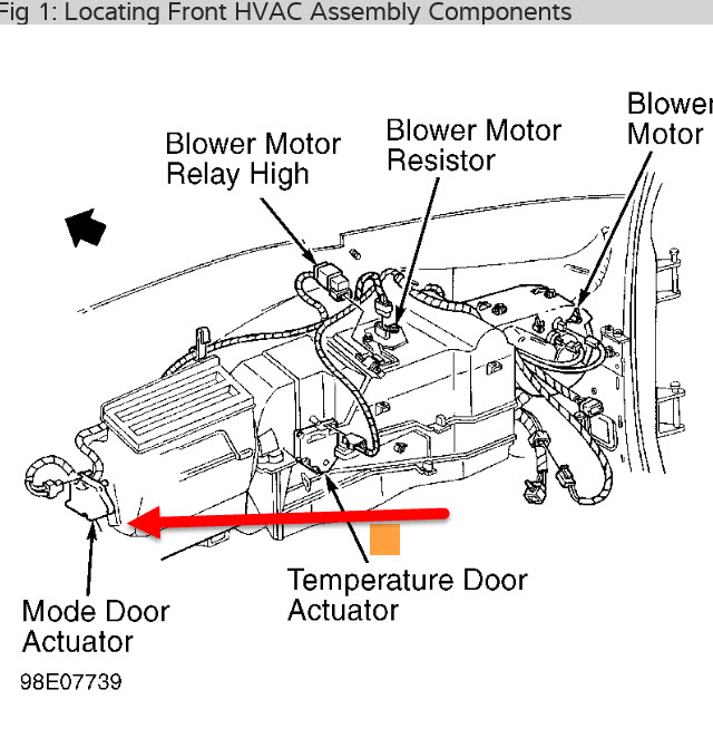

HMAC300
  • 48,601 POSTS

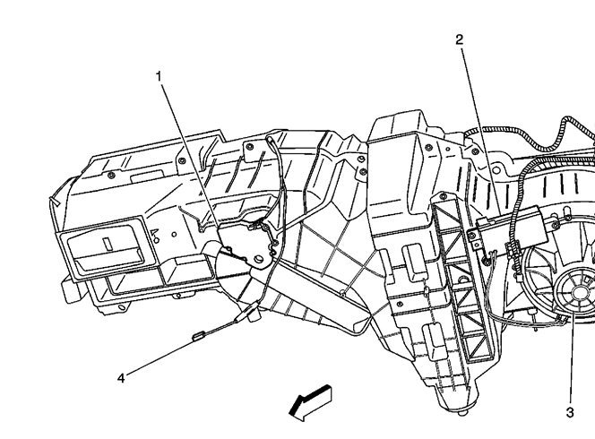

try puling the heater fuse and see if the control will reset. if not you'll have to see if your actuators are getting power to operate. i'll send a generic pic along to show where they are....

check blower motor relay under hood as well as fuse first. pull fuse on havac inside to reset actuators.there is also a tsb on this 10240 that the harness burns up from control to resistor so the harness has to be replacedas well as resistor part can be got from gm parts direct.com costs about $175 for both so check to see if harness is damaged and you don't have a cabin filter in your truck

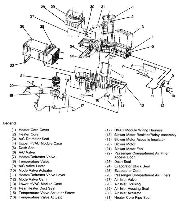

Squirrels/mice are not a good thing to have in there. Is it possible that there is other material blocking the airflow around the cores if they were inside? I would probably pull the system apart and clean it all out as both rodents can carry things I would rather not breath.
With the fan on can yo switch from floor-dash-defrost? How about hot-cold? If those work but you have low flow blockage is very likely the issue.

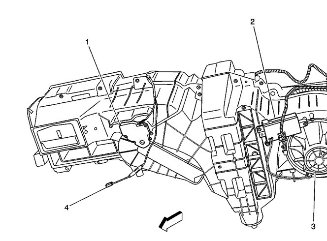

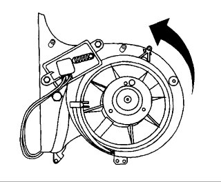

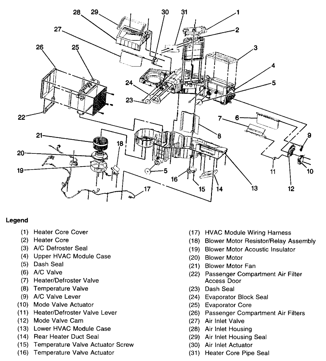

As the mode doors seem to be working I suspect the blockage is down in the blower area itself, around the squirrel cage. Item 20/21 in the image. I would drop the blower motor out the bottom and see what you find. It is real simple, remove the sound deaden-er cover screws, disconnect the wiring, drop the cover off, release the tab and turn the motor counter-clockwise to disengage it from the housing. Maybe put a plastic bag under it, just in case it has debris in it. With the blower out you can use a light and a vacuum hose to clean out the housing of whatever you find.

There is a tab you press in and rotate the motor counter clockwise and the blower drops out. Sort of a child proof blower....

HMAC300
  • 48,601 POSTS
try pulling heater/A/C fuse inside truck It may reset actuators. if not it may be the mode actuator that is bad. it is above gas pedal. See picture.
