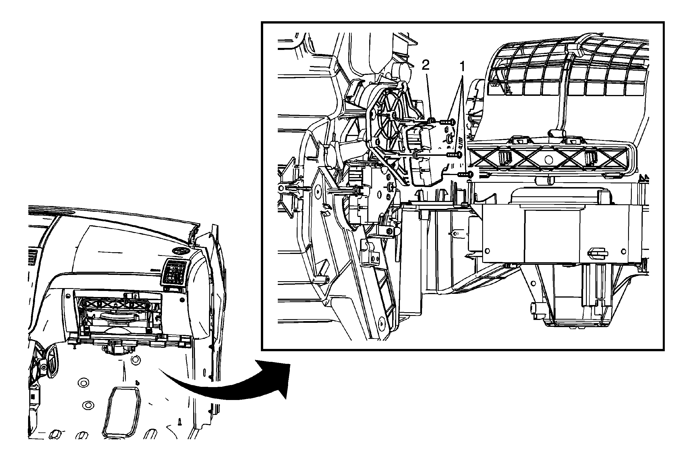

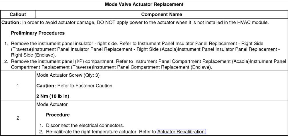

The problem I have is that i only have air coming from the floor heater. The rear vents and floor work fine. When i change from hot to cold the temperature works also, just no change from heater to A/C or defrost. Looking for any help.
