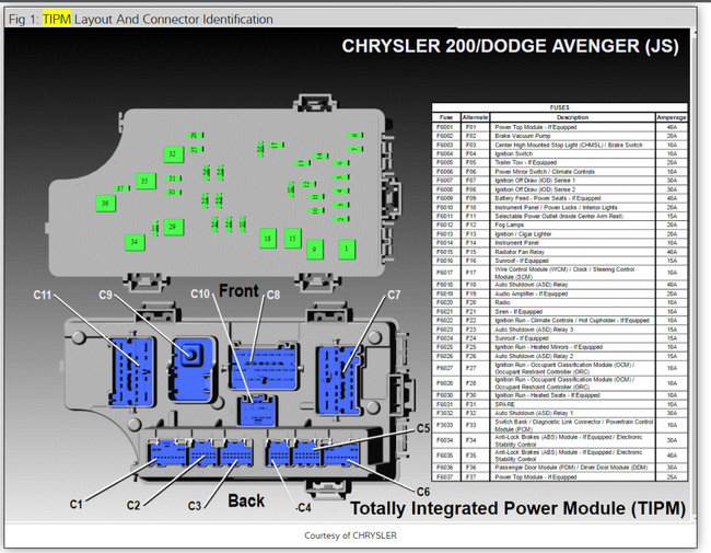

It sound like the system needs to be calibrated. Please turn the key on without starting the engine. Then remove the HVAC fuse #6 for five minutes then turn the key off. Reinstall the fuse and then see if the system works.
Below is a fuse location.
Check out the diagrams (below).
Please let us know what you find.
