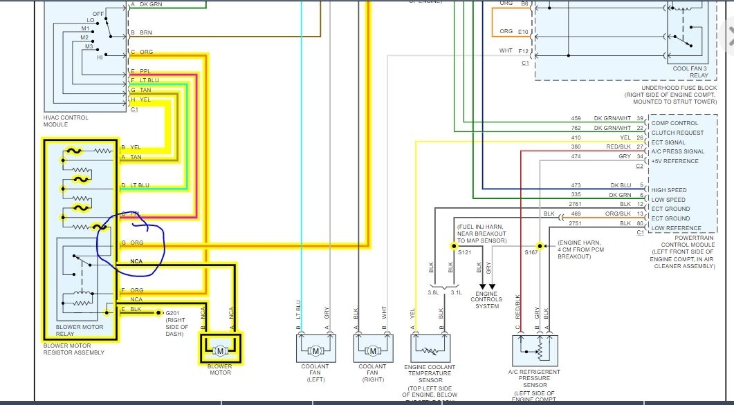

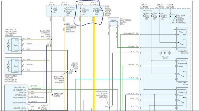

The A/C in my car stopped blowing air all together.
Jun 6, 2020 at 11:16 AM
Good afternoon,
The most common cause is a blower motor but needs to be confirmed.
I attached a wiring diagram for you to view so we can do some testing to confirm.
