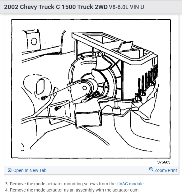

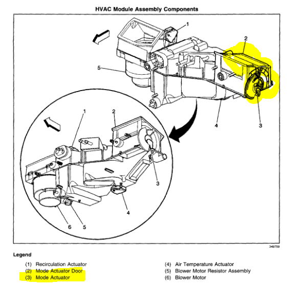

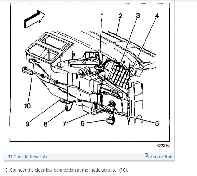

If you are unable to change the airflow direction and you see the mode door actuator respond to a change, then either the mode door actuator cam has failed, or something has broken on the door itself.
What I suggest is this. Remove the actuator and inspect the cam and where everything connects. While it is removed, move the door to see if you can direct air from the vents.
Let me know what you find. Also, I attached two pics below to make sure we have the correct components. The info is for manual climate control. If you have automatic climate control, let me know.
Also, here is a link you may find interesting:
https://www.2carpros.com/articles/air-vents-stay-in-the-defrost-position
Take care and let me know if you have questions.
See pics below.

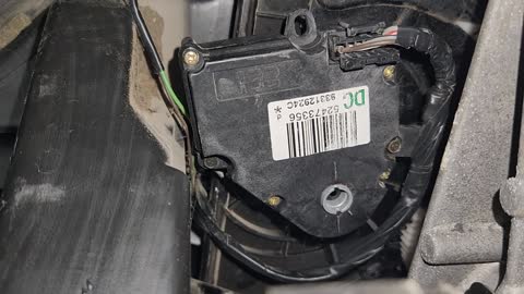

I haven't taken the actuator out yet but the white gear controlling the door, I believe, was not engaging with the actuator. The actuator was not moving far enough. I was able to assist it back in place, but it is a few teeth off and won't completely switch to defrost now. Vents have air just not defrost now that I moved it in place. I'm leaning more towards the actuator going bad and not fully rotating.

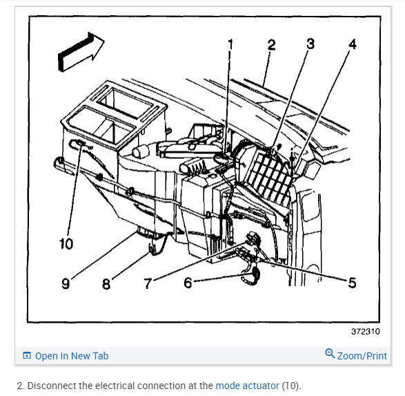

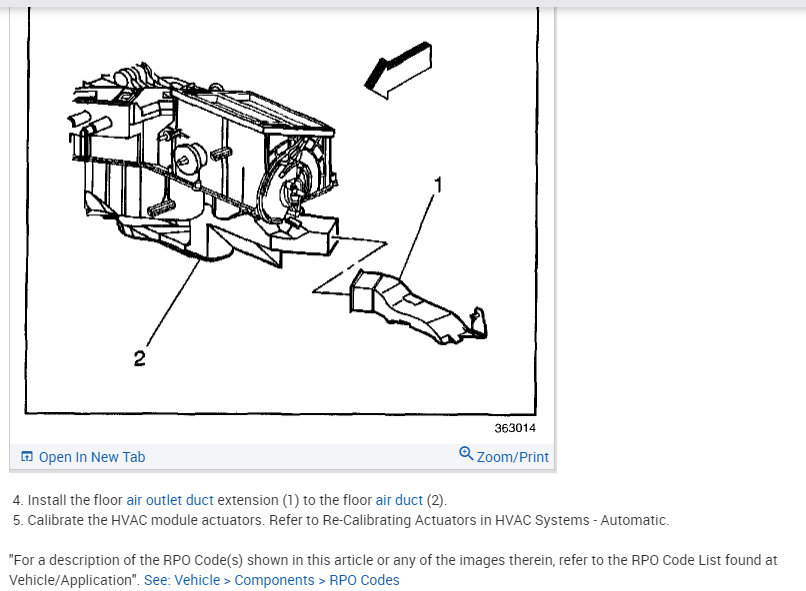

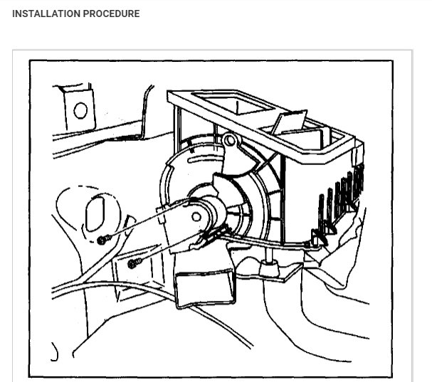

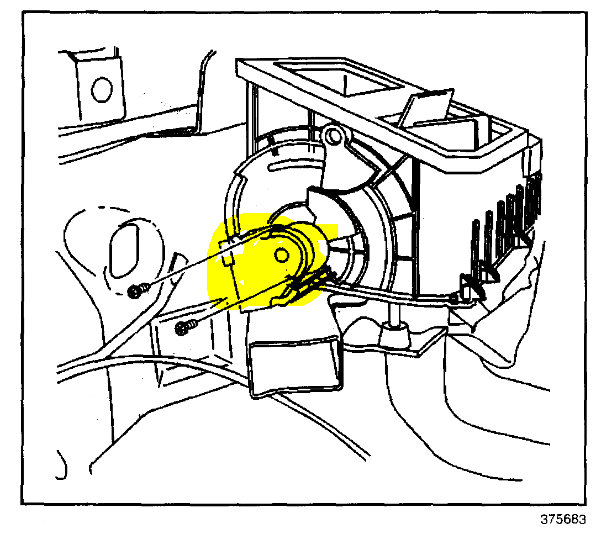

By any chance, do you hear a clicking sound from the actuator? There are plastic gears in it that fail and then the actuator can't properly operate.
As far as tips for replacement, I attached the directions below specific to this vehicle. I selected a system without RPO D07, which is a center console. If you do have one, let me know.
Let me know if this helps. I highlighted the area that I believe will be of most interest for you.
See pics below.

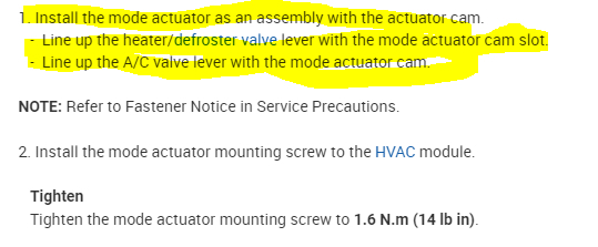

This is becoming a nightmare. When I get the defrost round pin lined up and then the white gear, which took forever, install the screws no it won't turn at all. I remove it, plug it in and it turns just fine. This is a new actuator. If I move the white gear the defrost round pin falls. You can hear the doors letting go. What I need is to know exactly how to have the white pins and gear oriented along with the actuator.
Sep 16, 2022 at 2:58 PM
I noticed that it has been a few days since you were contacted. By chance, have you been able to get things aligned? If not, here is what you need to do.
You have to install the mode actuator as an assembly with the actuator cam. First, line up the heater/defroster valve lever with the mode actuator cam slot. Then, line up the A/C valve lever with the mode actuator cam.
At that point, you can install the mode actuator mounting screw to the HVAC module.
Let me know if that helps.
