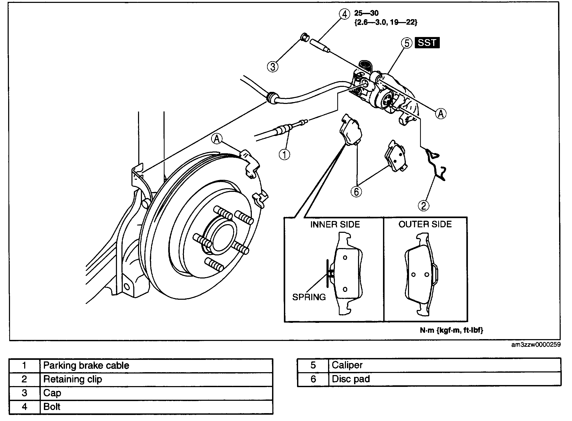

Here are the directions specific to your vehicle. The attached pics correlate with the directions.
________________________________
2007 Mazda 3 L4-2.3L
Rear
Vehicle Brakes and Traction Control Disc Brake System Brake Pad Service and Repair Removal and Replacement Rear
REAR
DISC PAD (REAR) REPLACEMENT
1. Remove in the order indicated in the table.
2. Install in the reverse order of removal.
3. After installation, pump the brake pedal a few times and inspect the following:
- Parking brake lever stroke
- Brake drag
pic 1

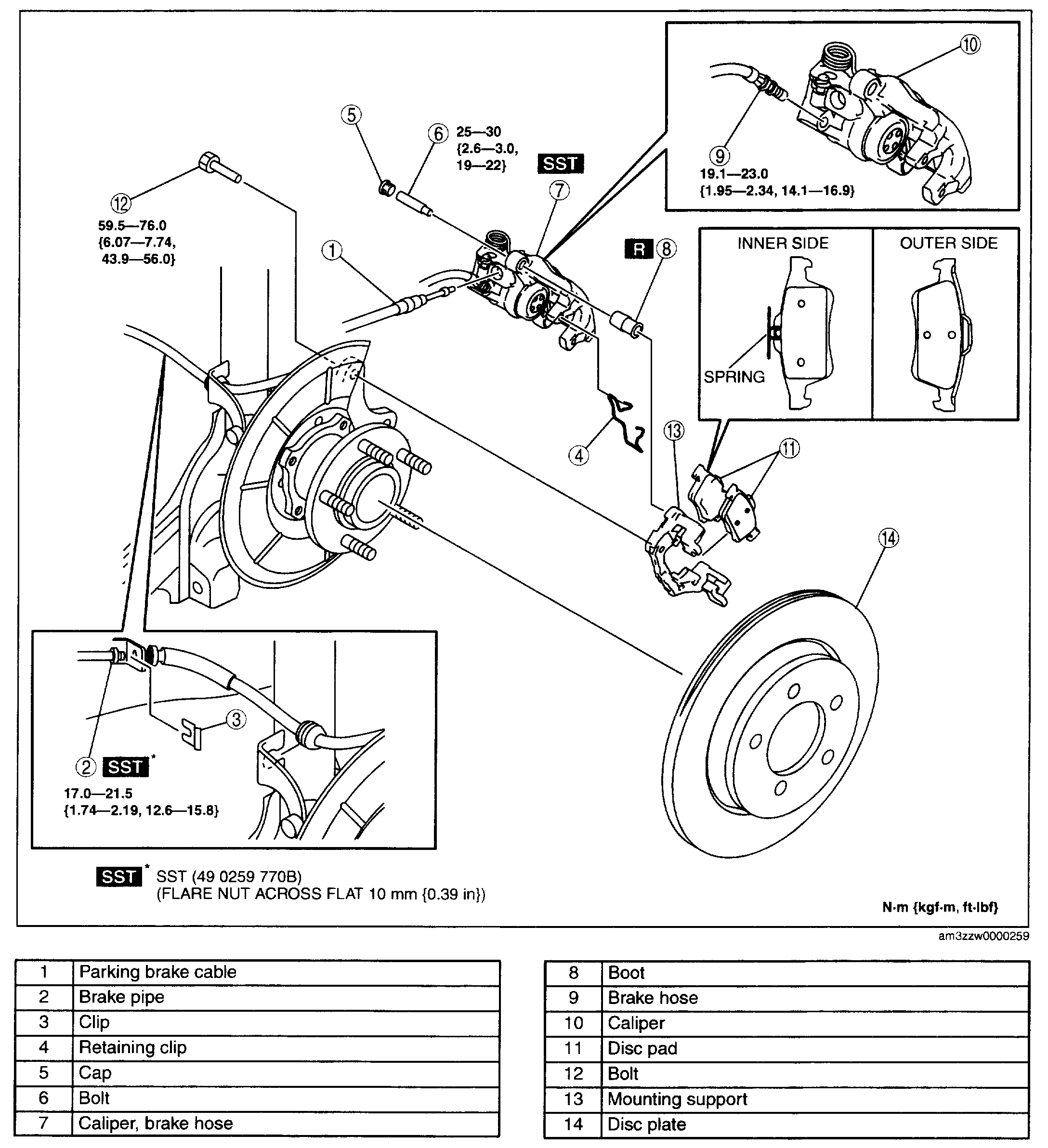

Brake Rotor Replacement
Rear
Vehicle Brakes and Traction Control Disc Brake System Brake Rotor/Disc Service and Repair Removal and Replacement Rear
REAR
REAR BRAKE (DISC) REMOVAL/INSTALLATION
- Brake drag
Pic 2
