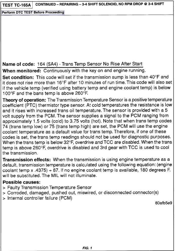

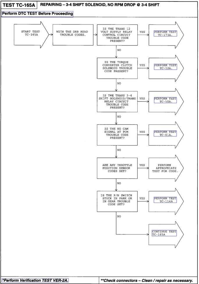

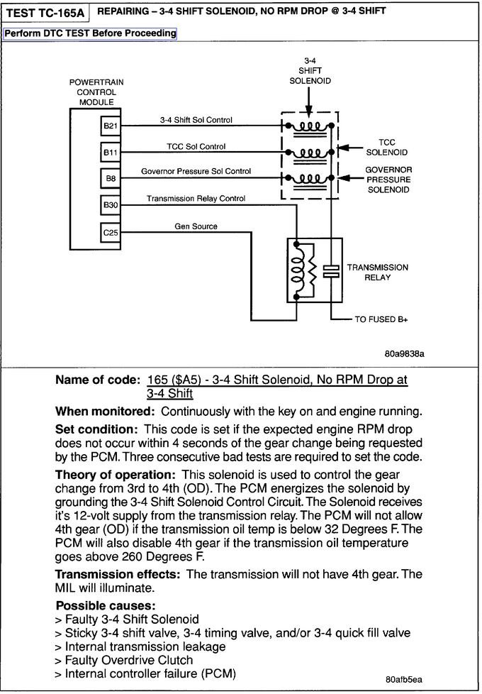

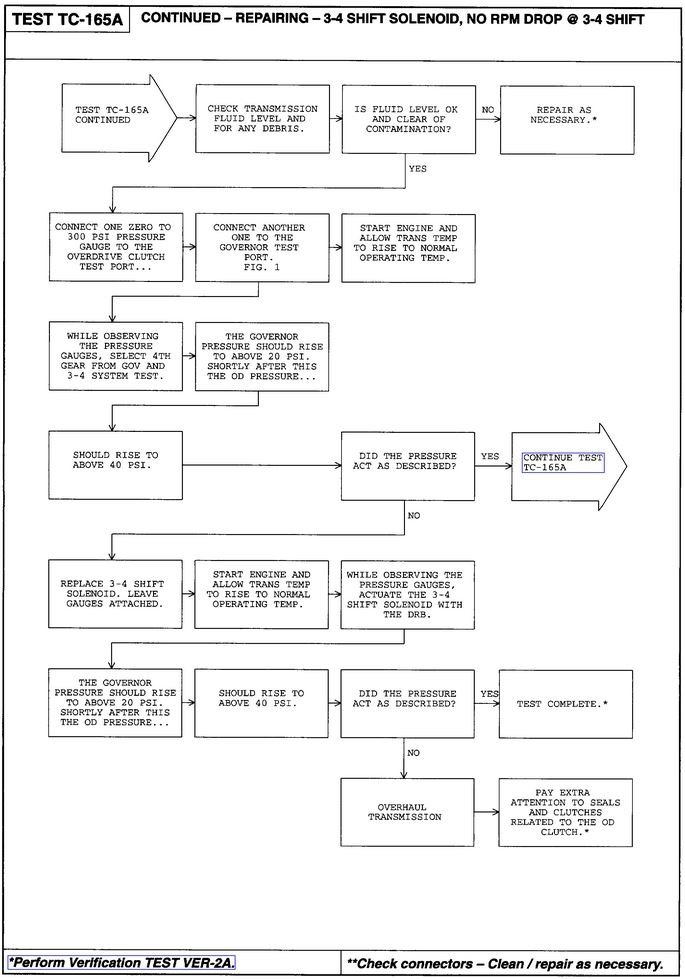

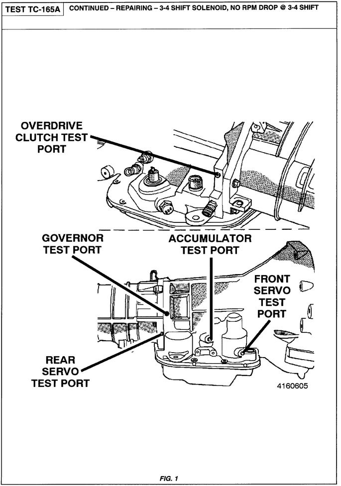

Second, regarding the P0783. Please take a look at the diagrams below.
Also let me know about the first code in your post.
Regards
Jon

And what are you suggesting I do with those pictures, seems like I need to preform a TC-50A test? Confused on the information you provided.
