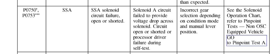

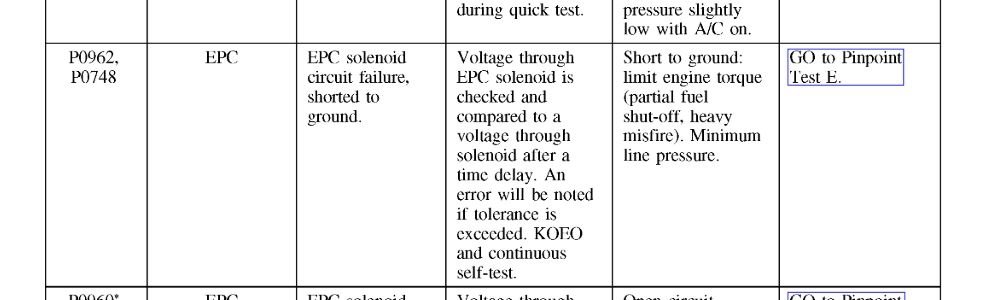

P0748 and p0750.

Got it.
These codes are electrical codes related to the wiring harness inside the transmission.
You need a scan tool that can monitor the actions of the solenoids and switches.
