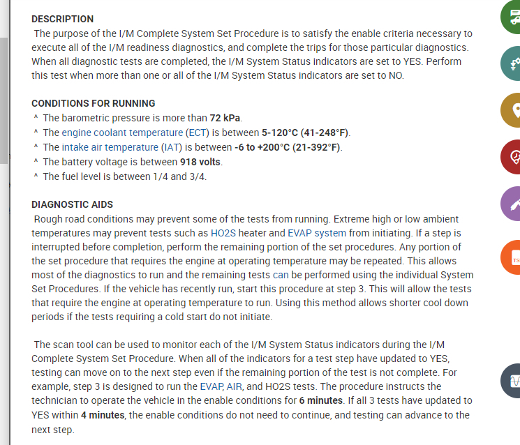

Did this previously have some codes and you erase them or do a battery disconnect before the inspection? This will wipe the monitors and require the drive cycles to be driven again to ensure there are no issues with the systems.
Here is a guide that helps with this issue:
https://www.2carpros.com/articles/smog-test-inspection-information

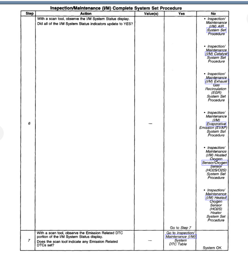

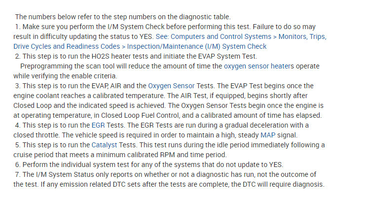

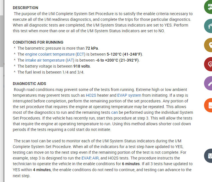

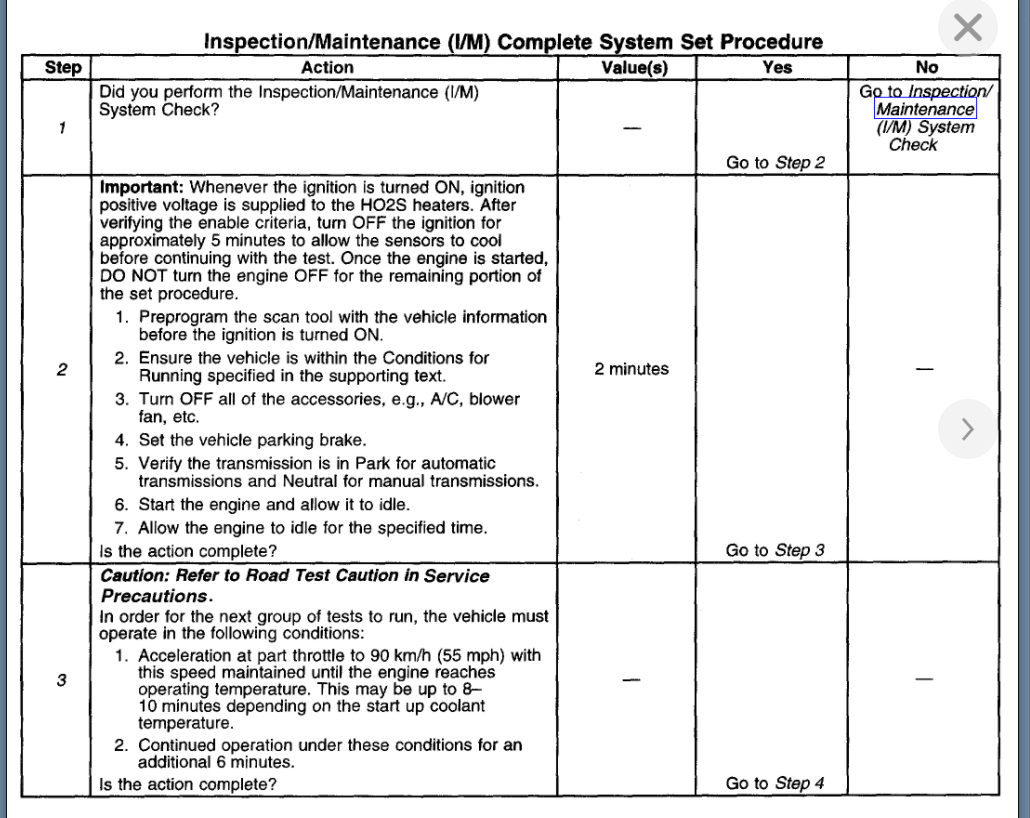

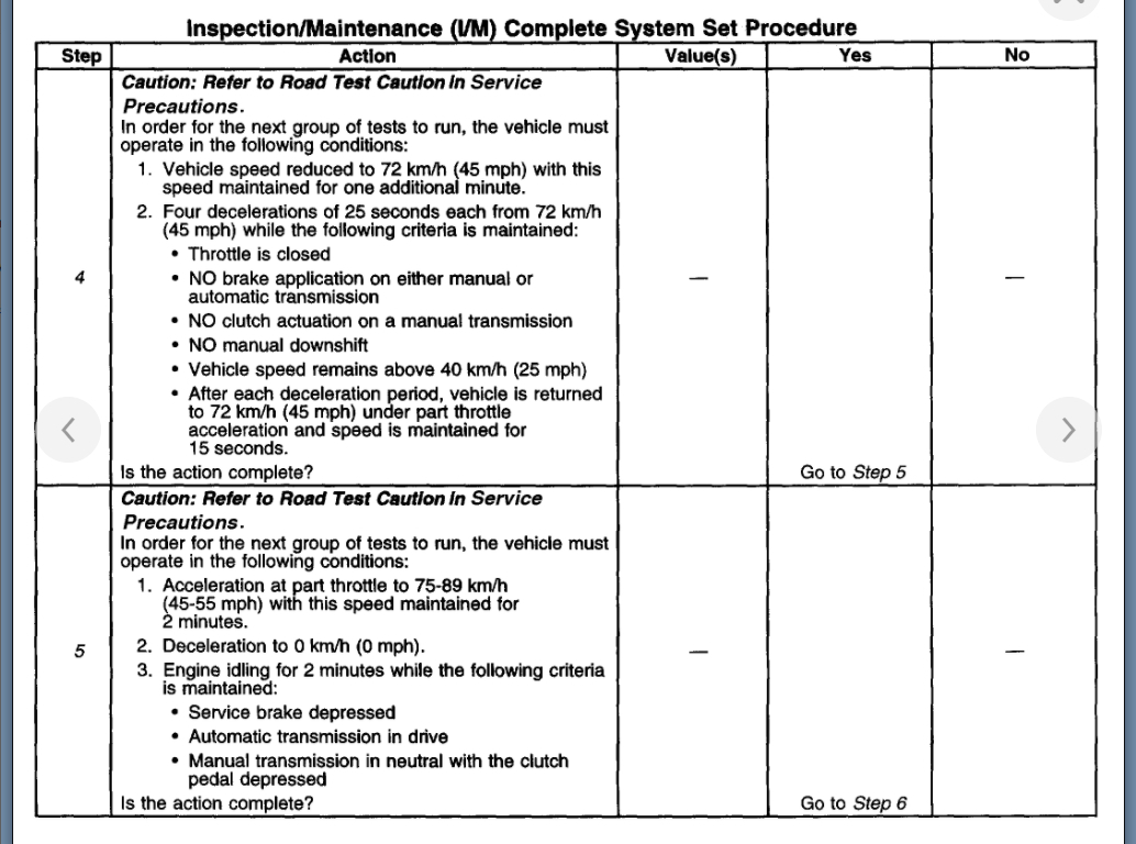

I am attaching the info below from the manual that will take you through how to drive the vehicle in order to force the monitors to run. While driving 200 miles will get some of the monitors to run it doesn't always work as you have found out.
As you will see, there are very specific situations that need to happen in order to get them to run and in some instances, it can take months to get all of them to run again depending on drive style.
Please review all these attachments and let us know if you have questions on this.
