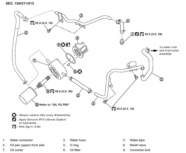

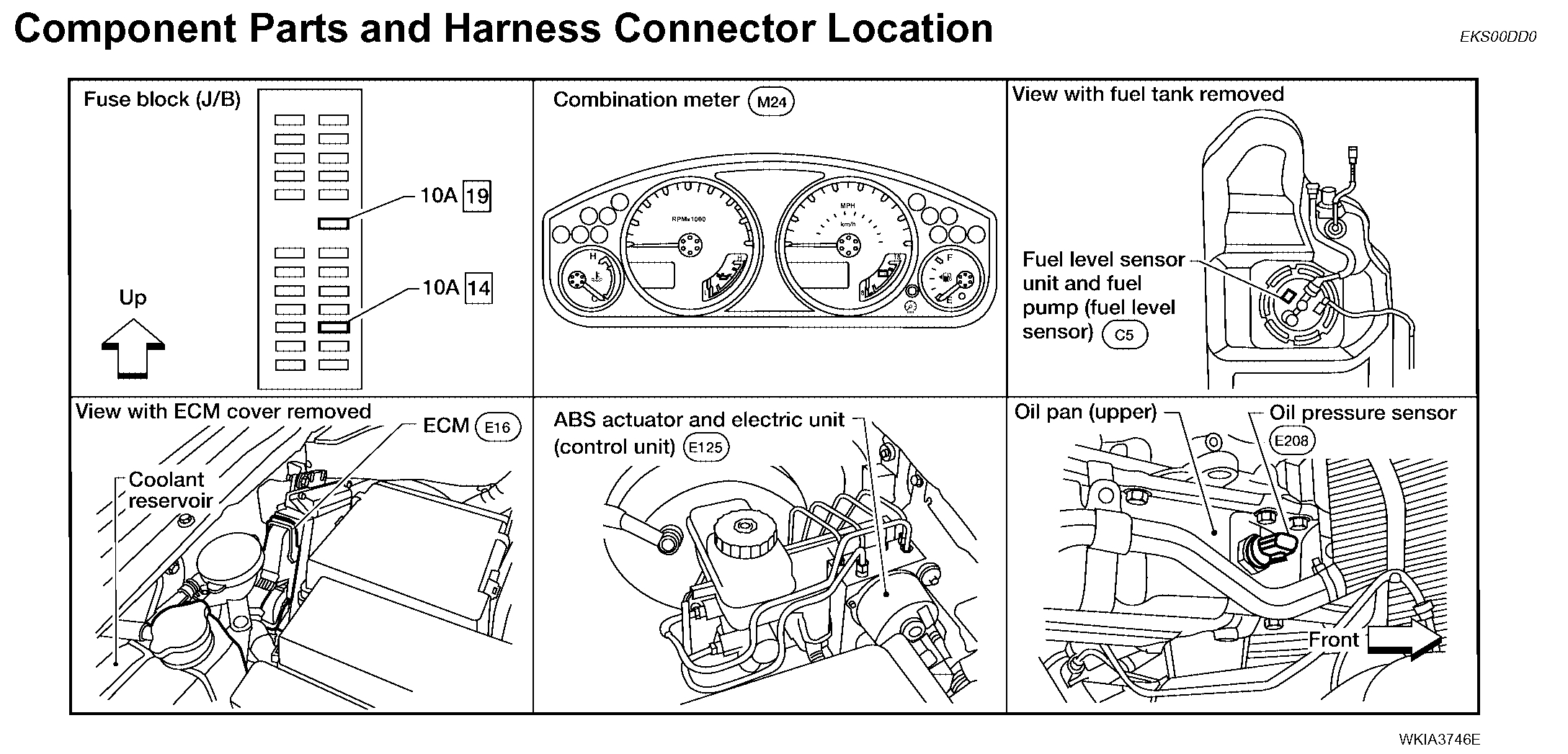

There is a good chance it is the sending unit. The sensor is crimped together (plastic to metal) and over time, that crimp weakens. Often times, the sensor will start leaking. The leak allows pressure to partially bypass the actual sensor. Thus, you can show low readings or unsteady readings.
Keep in mind, it is normal for oil pressure to change with RPM's. The faster the engine turns, the more pressure is produced.
Check the sensor and its wiring first. I attached a picture of its location. It is on the right side of the engine (passenger side) in the upper oil pan. See picture 1 See if there are any leaks from it.

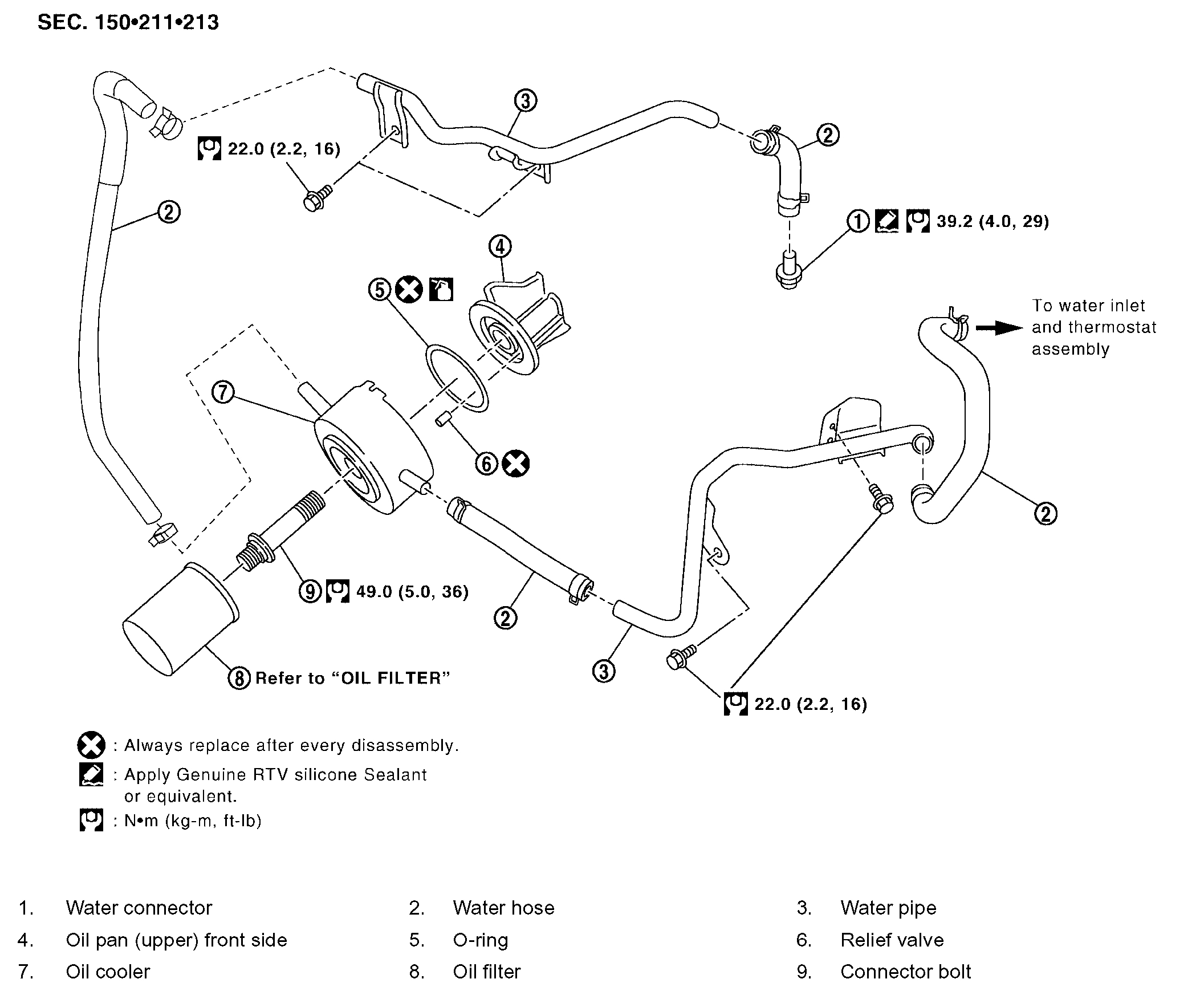

Now, there is one other thing that does not happen often, but behind the oil cooler (where the oil filter is mounted) there is a pressure relief valve. It is small and is pressed in. I have seen them fall out when the cooler is removed. Since you had engine work done with the oil pump, there is a chance it fell out. Actually, I have seen them fall out when the cooler is removed. In the second picture, locate part number 6.
You may want to check that if nothing else proves bad. You may also want to rent a mechanical oil pressure switch which will basically screw into the same location as the electric oil pressure switch. By using a mechanical gauge, you can be more confident if the pressure readings.
One last thing, make sure you are using the correct oil viscosity and a quality oil filter. I have even see inexpensive oil filters cause pressure issues.
I have had many of these engines apart. So, if you have questions, let me know.

I cannot identify a noise from the video. As far as the oil pressure gauge, I bet there is a short to power. With the key on/engine off, the gauge was already centered. It should be at 0.
