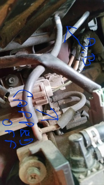

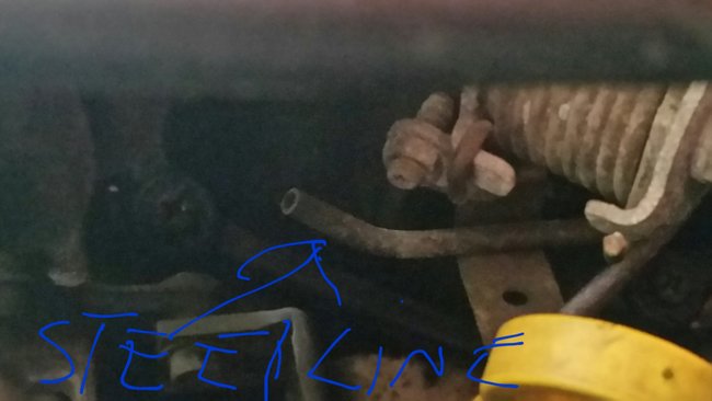

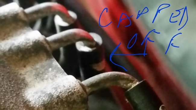

I found a vacuum line has been taken off and capped at both the air box where the filter is and on the back of the engine drivers side.
The car ran well before the distributor bearing went out though.
Well, replaced it. Did not fix the issue.

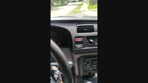

Can you shoot a quick video on how the engine is running so I can see? You can upload it here.
Jan 5, 2020 at 1:35 PM (Merged)
SHANNON DEYOUNG
  • 11 POSTS
Yeah, I will send you one. I just dropped a brand new MAF sensor in it. No change.
Car runs well at idle. A little miss in it. Really acts up going down the road.
Video in a few minutes.
Put a code reader on it. Multiple misfires on multiple cylinders. Coil pack. And fuel issues according to what came up.
Cannot really hear what it is doing in the video. But it has a slight miss at idle. Going down the road it backfires and sputters badly. The new MAF sensor is helping it maintain speed, but it still pops and sputters. Does not quit running at idle or stop lights.
Going to check the injectors next.
