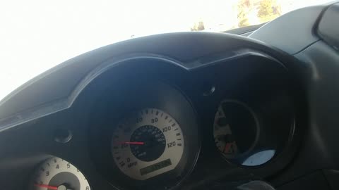

04XTERRAC
  • 11 POSTS
The video is poor quality, but you're able to hear the jerking right as it starts and I press the clutch around eleven seconds in.
Mar 9, 2019 at 3:20 PM

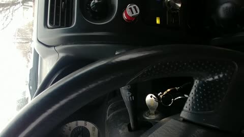

04XTERRAC
  • 11 POSTS
This is another video where it was present. It doesn't rattle every time I let off the gas, but often enough to catch, and it's very noticeable.
Mar 10, 2019 at 10:09 AM
Thanks for the videos. It sounds like the drive-line could be having issues. I would remove the driveshaft to check the U joints. Here is a guide to help:
https://www.2carpros.com/articles/how-to-remove-a-drive-shaft
