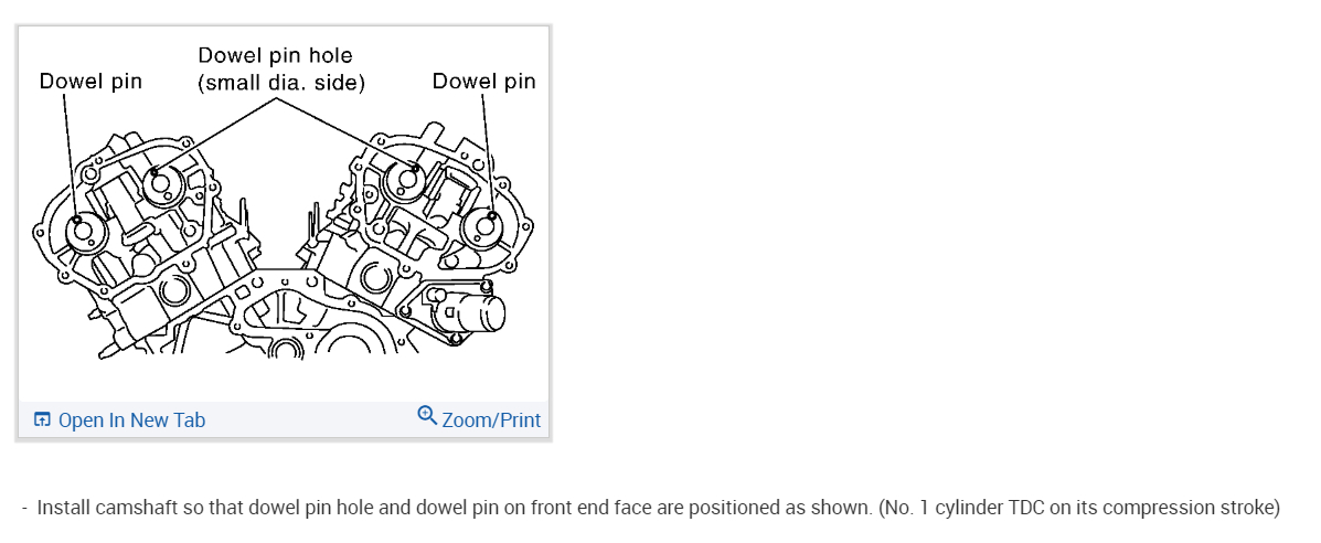

Can I get the camshaft timing marks please?
Oct 16, 2010 at 8:32 PM
SUJEET001
hi, looking for timing marks for nissan x-trail QR20 engine any help appreciated, thanks
Jun 8, 2012 at 1:53 AM
Here is the camshaft timing marks, make sure the engine is on TDC. Check out the diagrams (Below). Please let us know if you need anything else to get the problem fixed.
