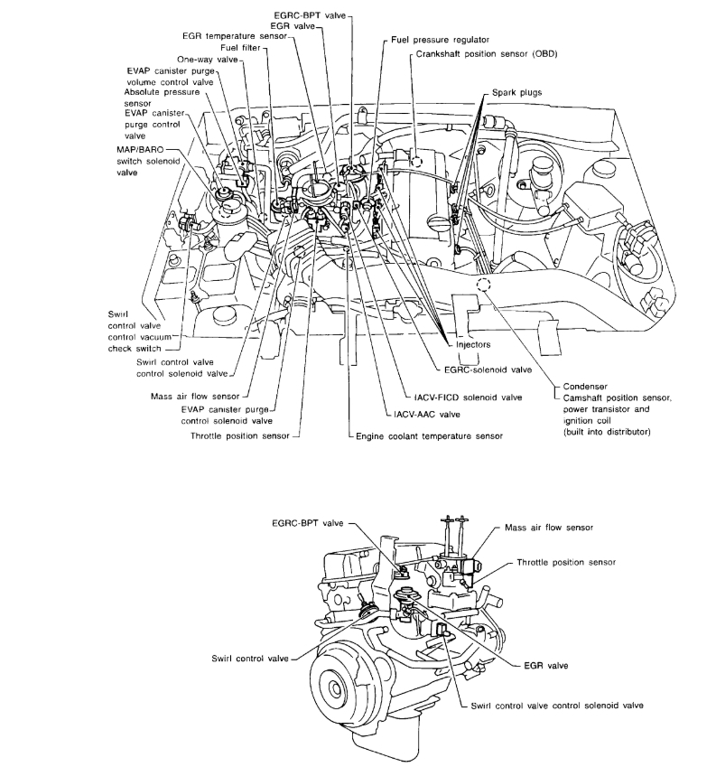

This happens when the EGR valve fails or the passages get clogged up and need to be cleaned out here is a video that shows how to check the valve and the location of the valve below.
https://youtu.be/DqUCbbKdWf4
Check out the diagrams (Below). Please let us know what happens.

P0400 = Exhaust Gas Recirculation flow. Most probably the EGR passage is clogged. You need to clear it of carbon deposits.
