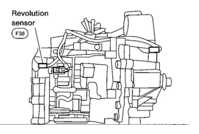

These cars had a problem with the input shaft speed sensor for the transmission. It should throw a code but not always. Here is a video of the job being done on a Honda but they are similar.
https://youtu.be/f3bETtCIdxM
Here is where it is on your car. (below)
You might have code for it here is a guide so you can see
Sep 30, 2017 at 10:19 PM
