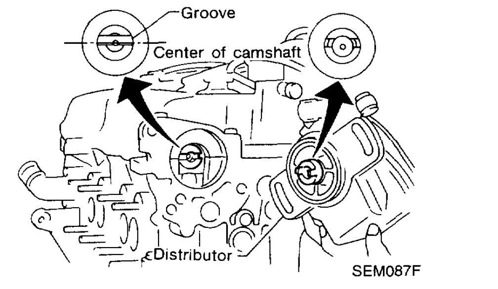

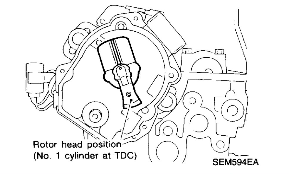

I attached pictures of setting the distributor in the correct way with the rotor.

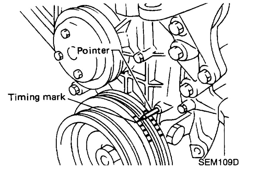

make sure you have the engine at top dead center compression stroke. remove number 1 spark plug and hand crank the motor until you feel pressure coming out of the spark plug hole.

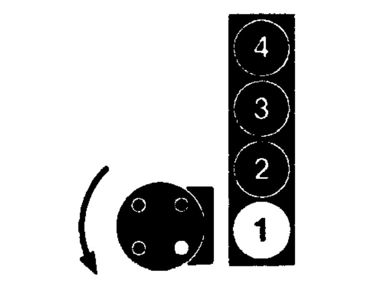

then match the pointer on the crank to 0 mark. then set the distributor as shown in the picture. the wires are also shown for the correct position.
The ignition timing is 0 degrees with a timing light.
The firing order is 1-3-4-2
