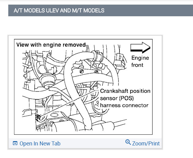

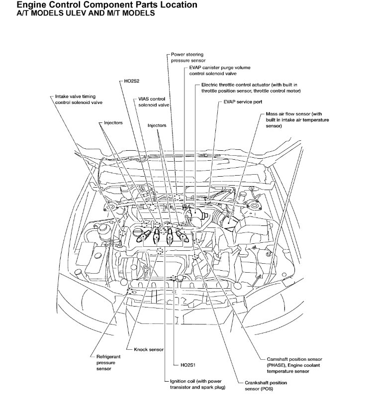

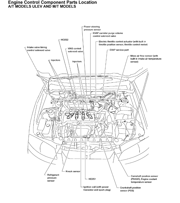

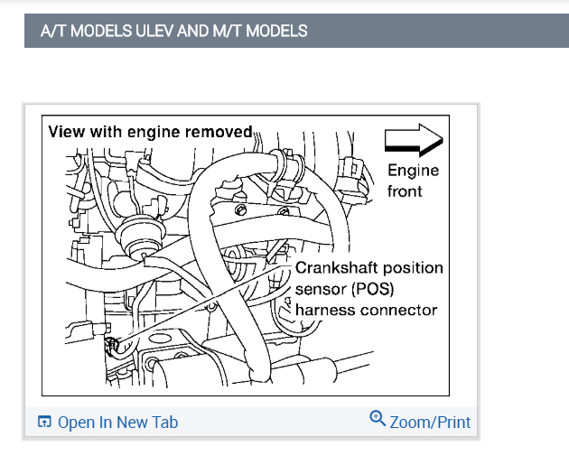

It sounds like the crankshaft sensor has stopped working here are diagrams and instructions on how to replace it. Check out the diagrams (Below). Please let us know what happens.

I have the exact same problem. I had to replace the sensor cost me $89.00 all set!
