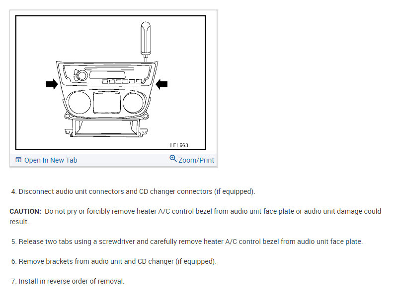

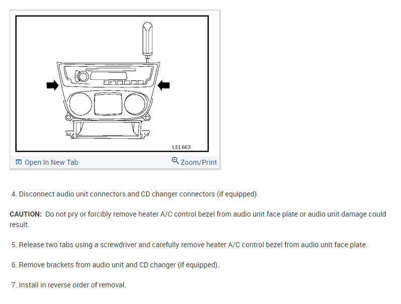

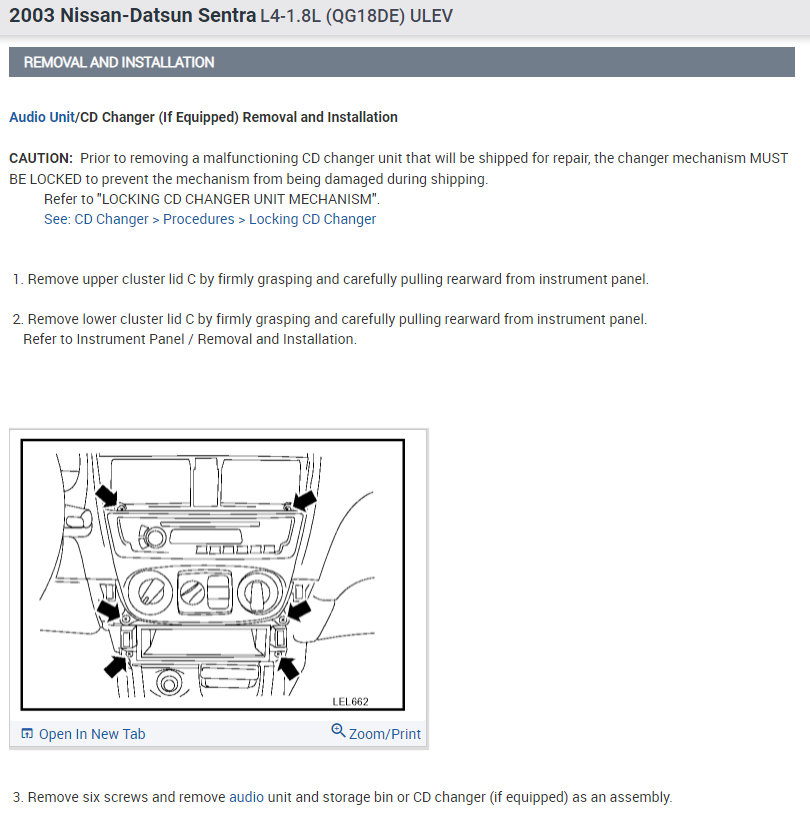

In order to fix this you will have to take apart the CD player and access that gear, if its loose then secure it with epoxy to the base. If its not attachable then you will have to replace the CD player.
Taking out the CD player is fairly staring forward. Simply take off six screws that holding the CD player in place. Pry gently and it will come out.
