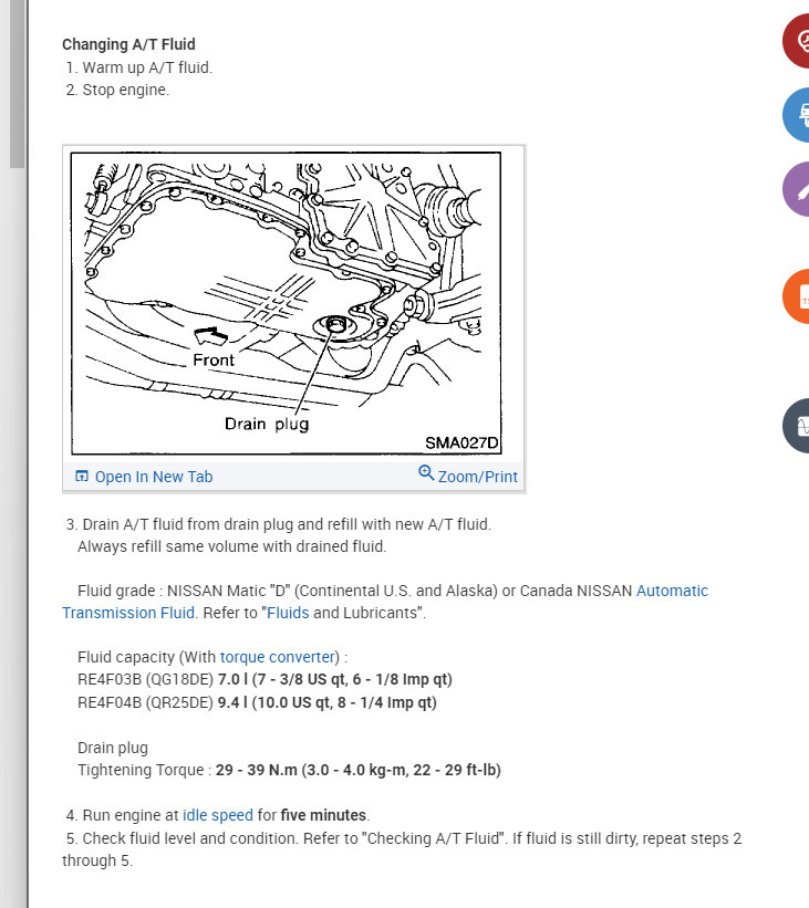

Once we know all this information, we will be able to make a better decision on what direction to go. However, the most likely cause of this issue is low or no fluid so I attached the process below on how to change the fluid because if this is low, it is a good idea to put fresh fluid in it and then we can find the leak as to where it is going.
Let me know what you find with this, and we can go from there. Thanks
