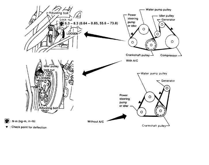

Ive loosened the lock nut and adjusting bolt and still can't get the pulley to release the old belt. Is there a pivot point/bolt or am i just missing something? and, is there a diagram to show me this? Thanks again guys.

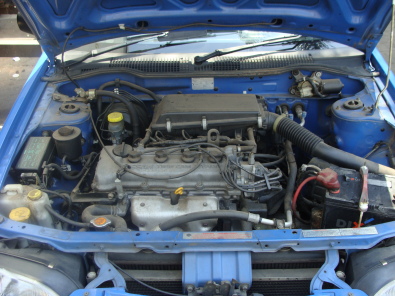

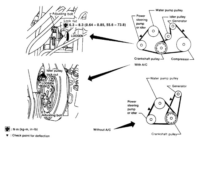

the belt has an idler pulley that keeps it tensioned, loosen that pulley. Here is a guide that will show you everything you need to see to change the alternator and all belts in this scar. https://www.2carpros.com/diagrams/nissan/sentra/1999
https://www.2carpros.com/forum/automotive_pictures/261618_Noname_2834.jpg
https://www.2carpros.com/forum/automotive_pictures/261618_Graphic_19.png
1.6L GA motor..
https://www.2carpros.com/forum/automotive_pictures/261618_Graphic2_103.jpg

For the A/C, you need to loosen the tension on the alternator. There are two bolts/nuts to loosen. The first one is the nut that is holding the tension bolt, and then the tension bolt itself. Once that is done, you can remove the belt from the alternator and A/C pulleys.
For the water pump, it is similar, but you need to do it on the power steering pump. If you are looking at the front of the engine (where all the pulleys and belts are), the P/S pump will be on your left hand side, next to the thermostat.
