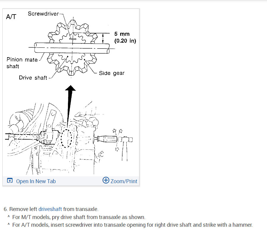

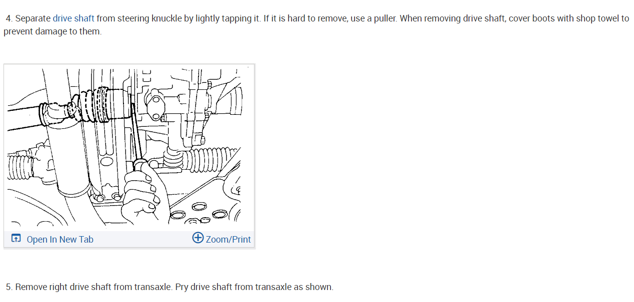

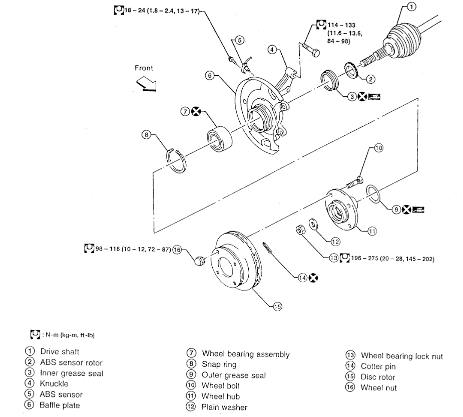

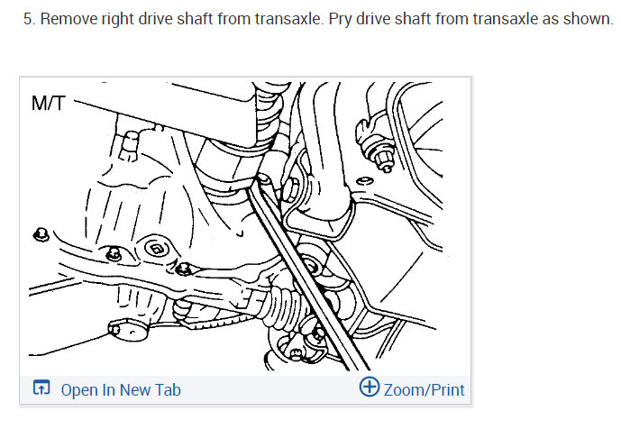

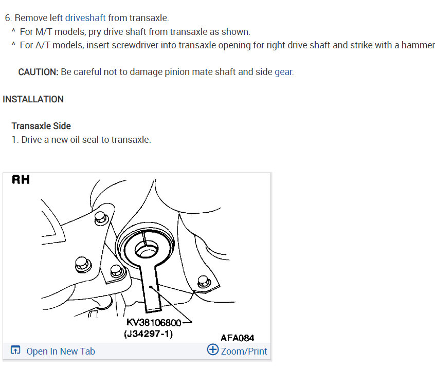

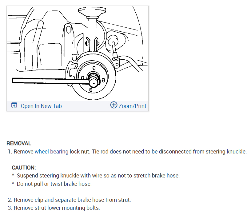

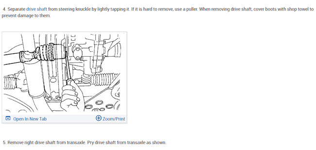

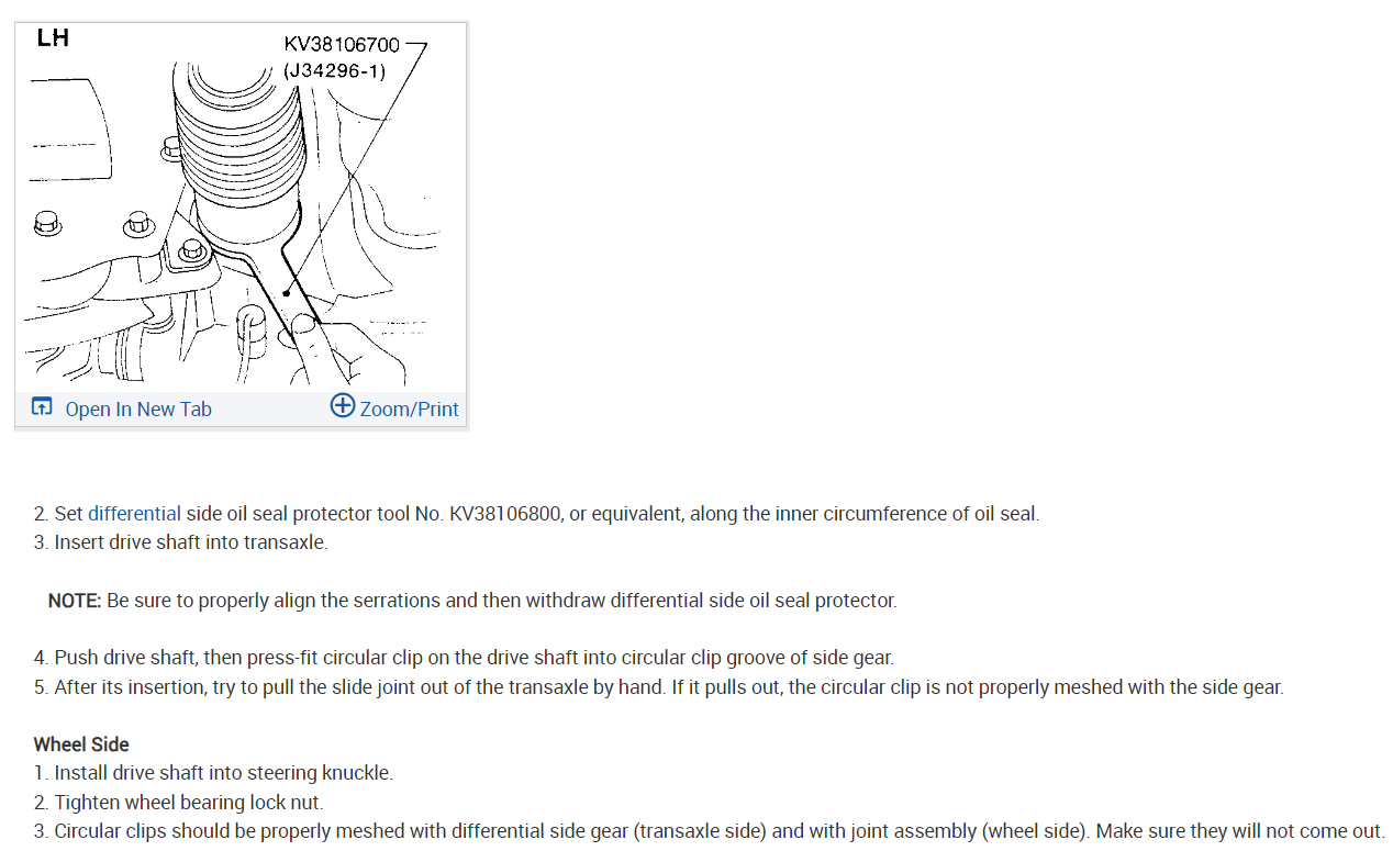

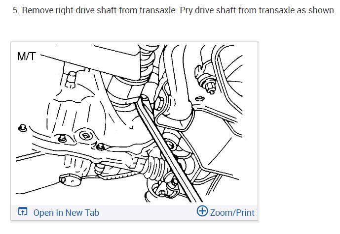

They really dont do CV joints anymore, instead they replace the CV axle which has become inexpensive, here is how to do the job, and I would check Amazon for the CV axle. This video show the job being done on a similar car.
https://youtu.be/9OYxj9y3Zjc?si=O1vCyTaKXX1cEoXx
