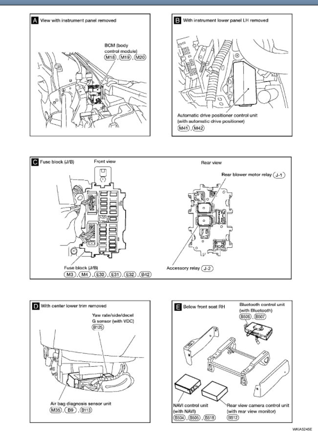

I need to check the fuses but cant find the panels or how to check them can you help me please?

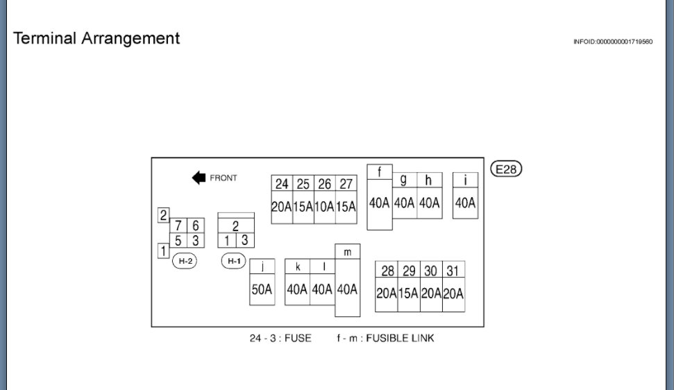

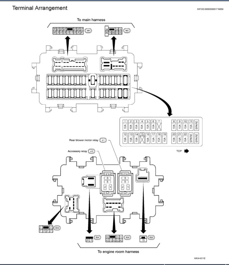

You will find the info below that you requested. However, here is a guide that will help with testing and replacing fuses:
Please see the info below and let us know if you have other questions. Thanks
