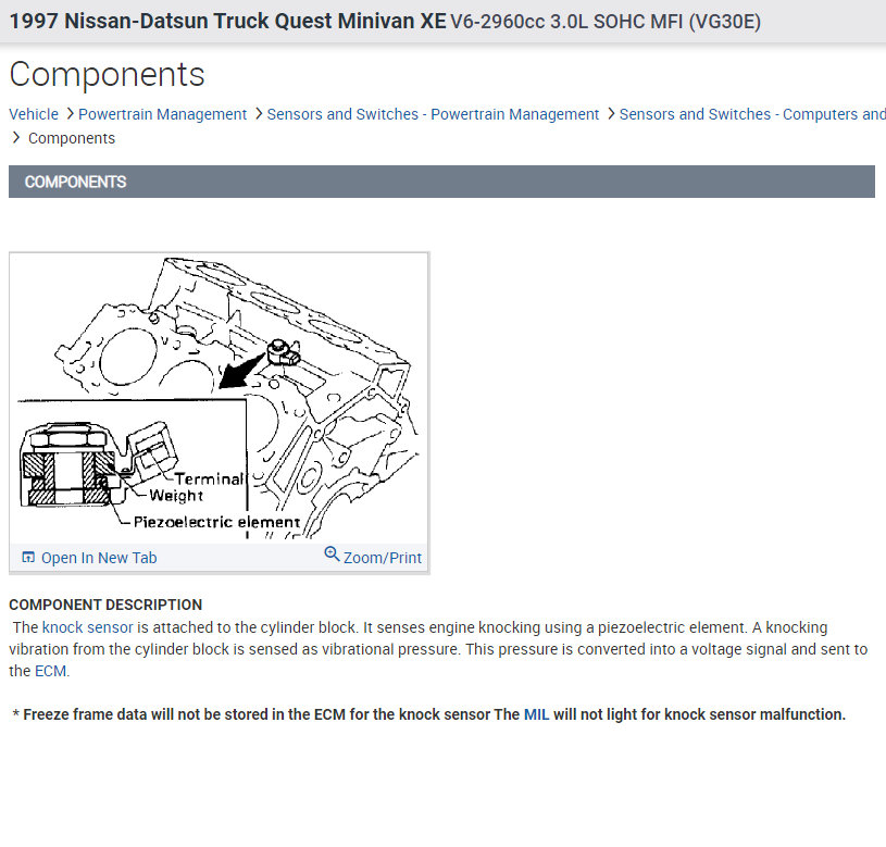

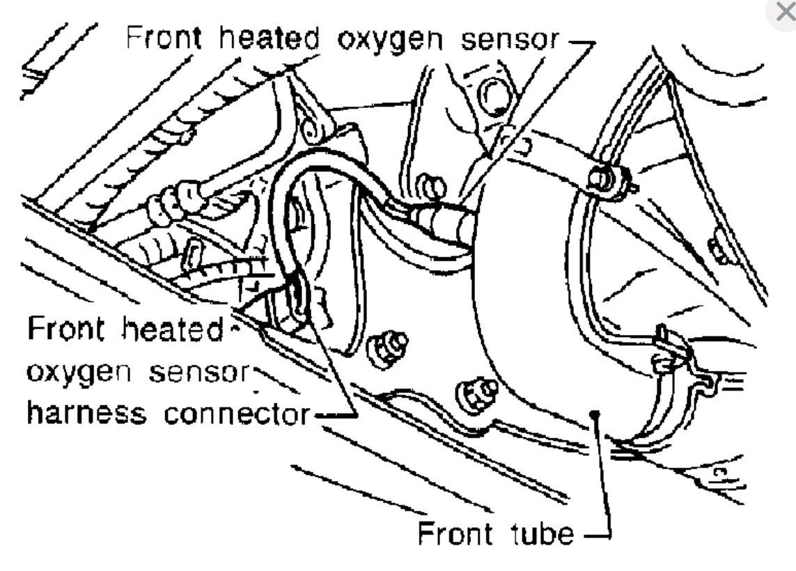

My check engine light turned on and i got it checked and i got the code P0130 Bank 1 Sensor 1. its the oxygen sensor but i dont know where it is located. i also got the code P0325 which is for knock sensor and i need to know where that is located also. so please reply asap.

The bank 1 sensor 1 oxygen sensor is the one before the catalytic converter, at the exhaust manifold. It is the left side oxygen sensor.

The knock sensor is located on the center of the engine block (see diagram). You will have to remove the intake manifold to access the knock sensor.
