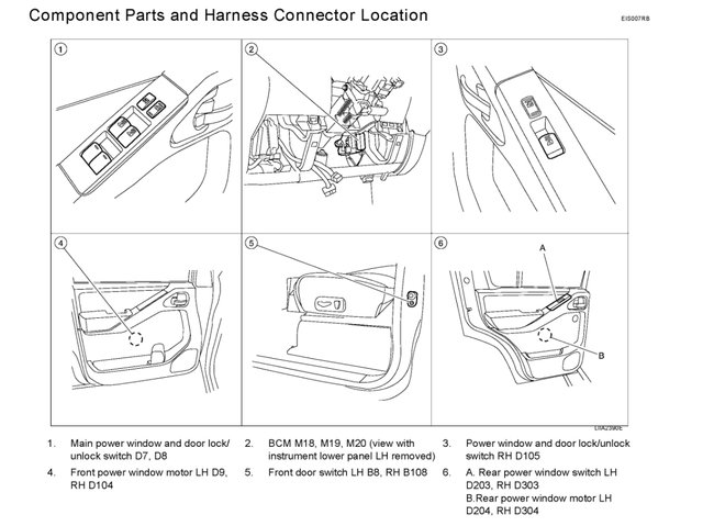

I am giving you the check for the LE model.................Looks pretty basic.
MOTOR TEST
Apply battery voltage between motor connector terminals. Window should move up or down. Reverse battery leads. Window should move in other direction. If window moves up and down, motor is okay. If window does not move as described, replace motor.
Basically you need to remove the door panel and disconnect the motor connector. Put 12V to one side of the motor connector and ground the other pin. Then swap for the motor to operate in the other direction.
Most likely it appears you have the regulator type system with the motor attached to that. What I have usually seen is the regulator has snapped, or a part broke off or bound up in some way then it shuts the motor off.
My suggestion is again, remove and do a good visual inspection on the regulator first. Then check the motor if the regulator looks okay.
Also, I would replace the motor AND the regulator even if just the motor is bad, or, if just the regulator is bad. They both have been on there for 162K and have worn together. Many times it is easier and just about the same price.
Looks like Auto Zone has the motor for about 70 and the regulator for about 45. Check with them to see if it comes also in one complete assembly.
