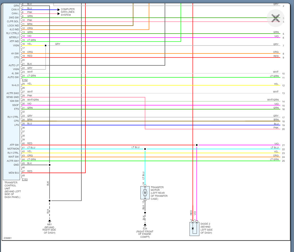

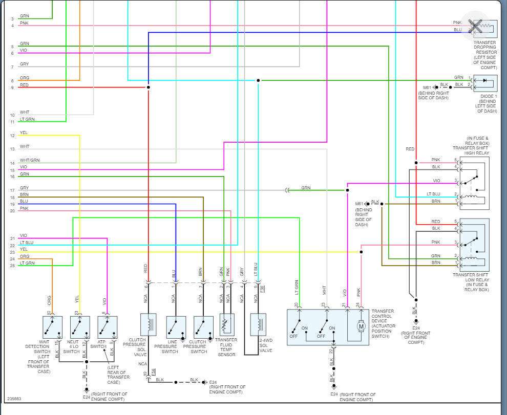

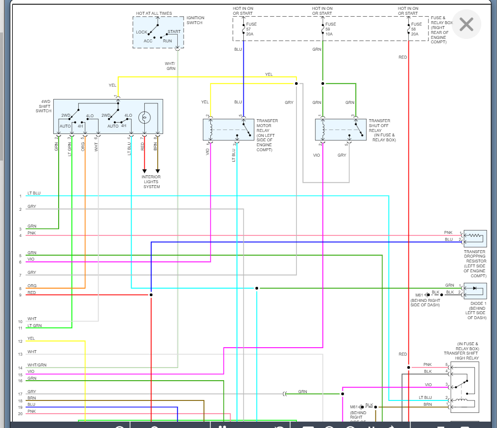

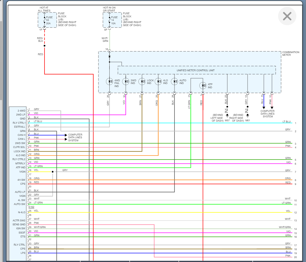

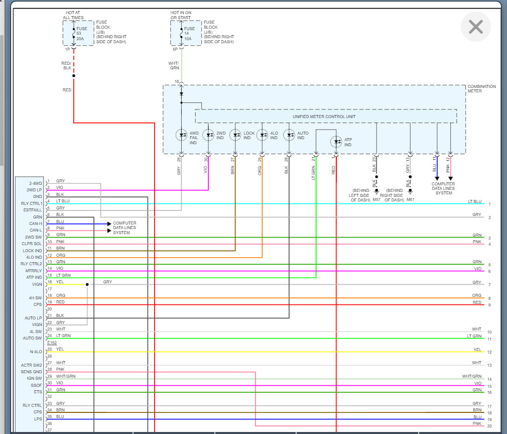

I just bought a used vehicle listed above and was putting it through the paces. When I switch from 2WD to 4WD (High mode), the 4WD indicator light flashes briefly and then stops indicating it is in 4WD. But, when I switched back to 2WD, the indicator light flashed for 6 minutes before it registered a static display indicating it is back in 2WD. Is this normal? Or do I have an issue that needs to be resolved?
