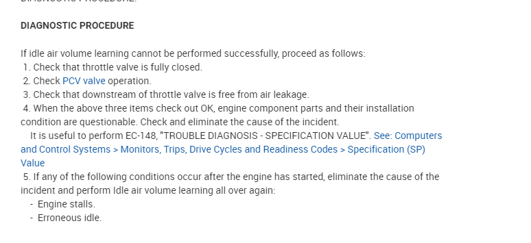

my mechanic accidentally cleaned the throttle control assembly, and the idle speed became erratic. After changing the throttle control assembly, the idle speed is 1,500 RPMs. i did a troubleshoot by removing the mass air flow sensor with the engine running but there was no change in the high idle. how can i reduce the idle speed?
