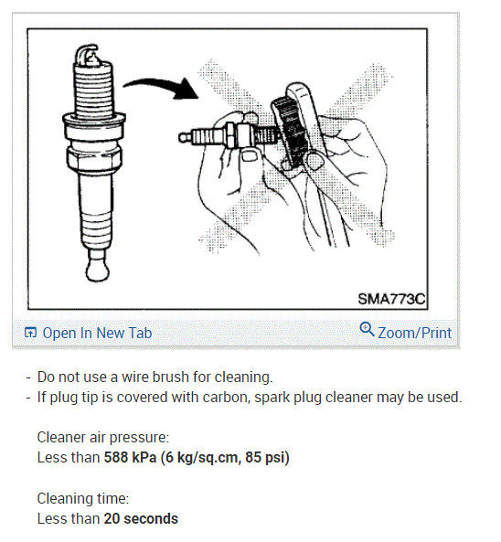

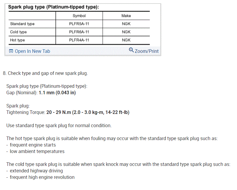

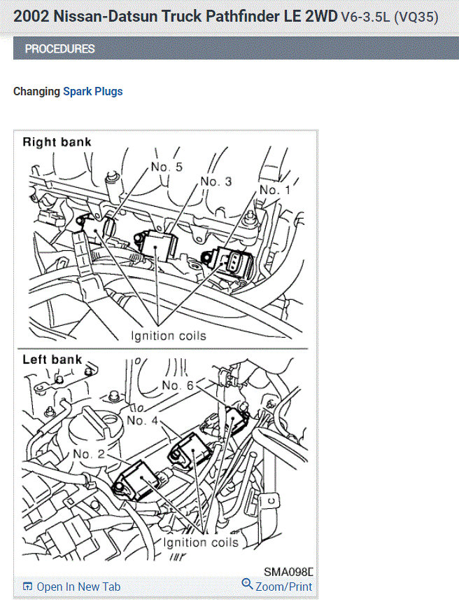

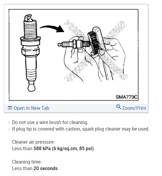

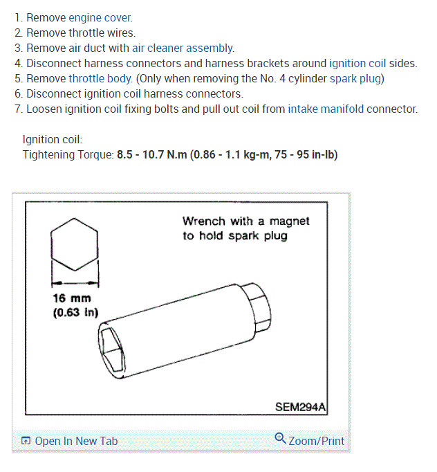

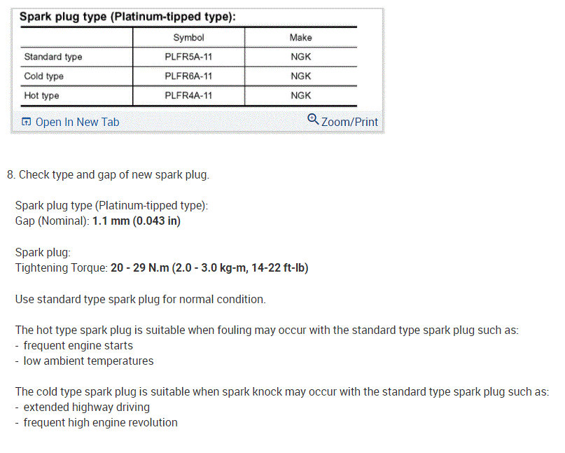

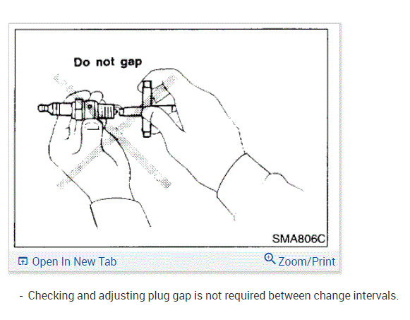

The attachments below are the directions specific to your vehicle for replacement.
I hope this helps. Let me know if you have other questions.
See pics below.
