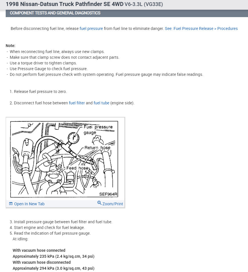

If you are able to start it with starting fluid, then it means that the engine is not getting fuel.

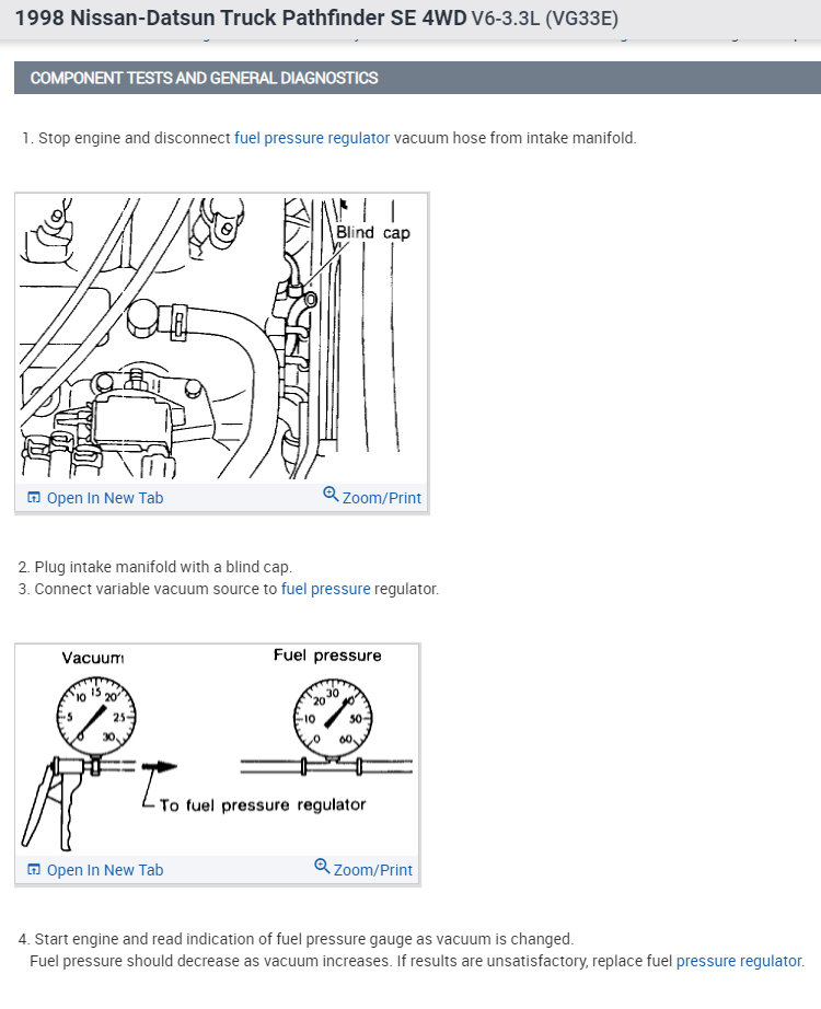

As you have a new fuel pump, it could be due to a clog in the fuel line or a bad fuel pressure regulator.
Check the fuel pressure using a pressure gauge. This vehicle should have 34-43 PSI of fuel pressure.
I have attached the fuel pressure regulator testing procedure below.
