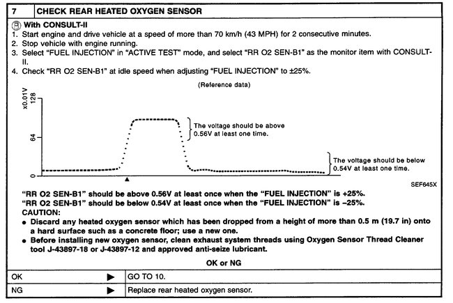

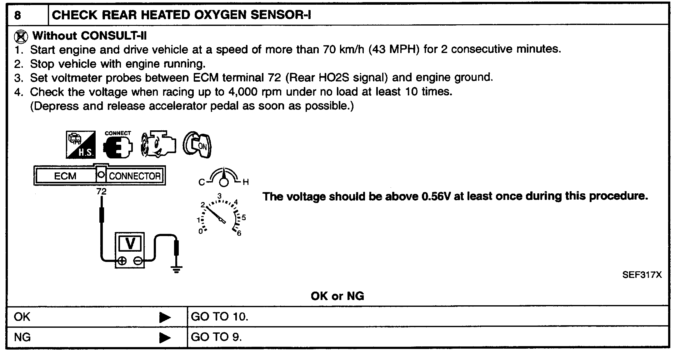

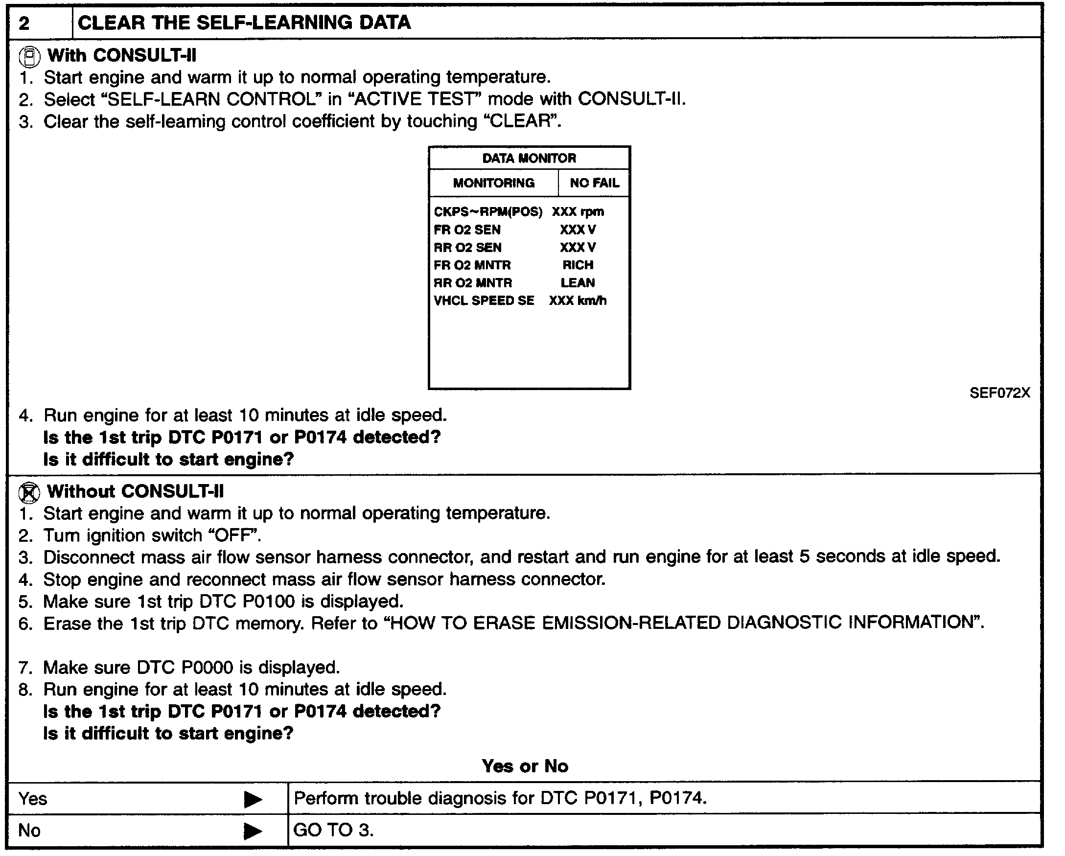

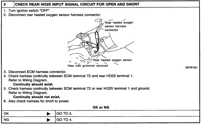

The code you have pertains to the heated oxygen sensor (sensor 2) which is post cat. What I suspect may be happening is the vehicle isn't controlling the air fuel mixture properly which can cause a power loss.
There are a few things that can cause this code to present itself. For example, a harness or connector issue, the sensor circuit is shorted or open, the sensor is bad, fuel pressure, injector issues, even intake engine vacuum leaks.

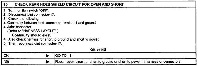

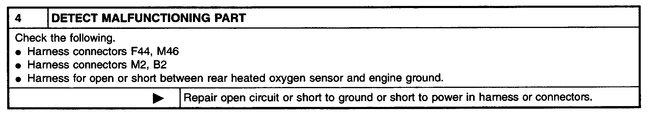

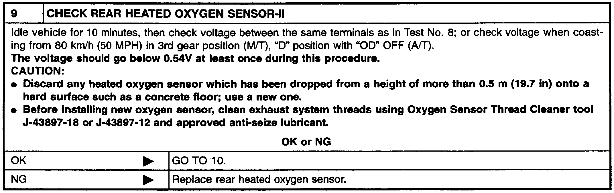

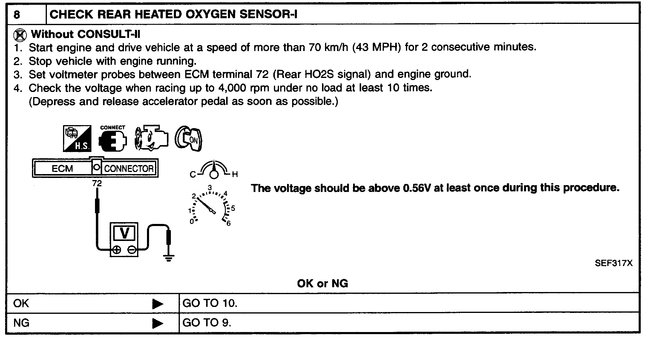

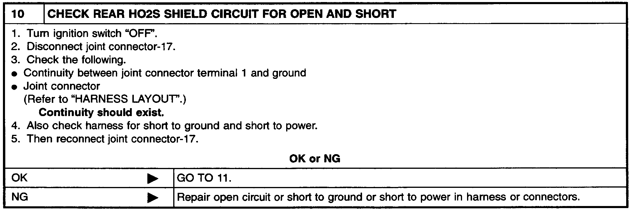

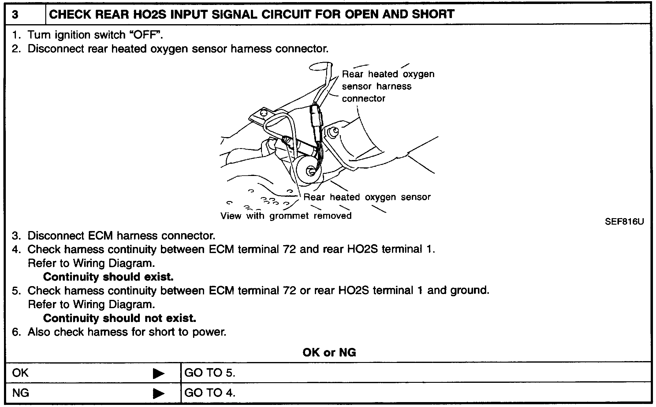

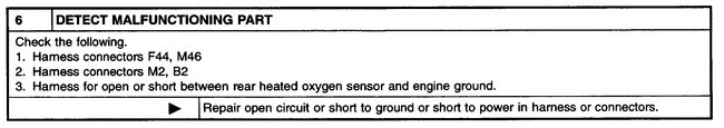

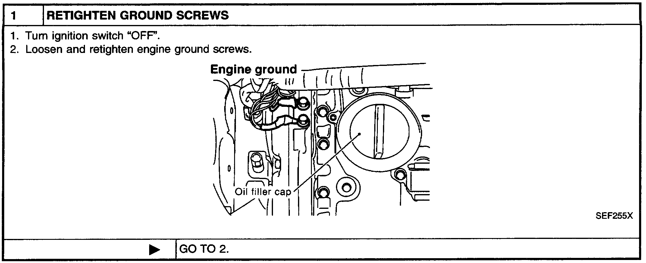

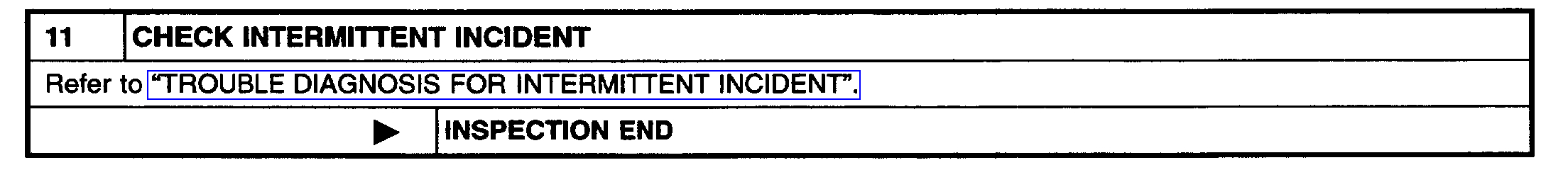

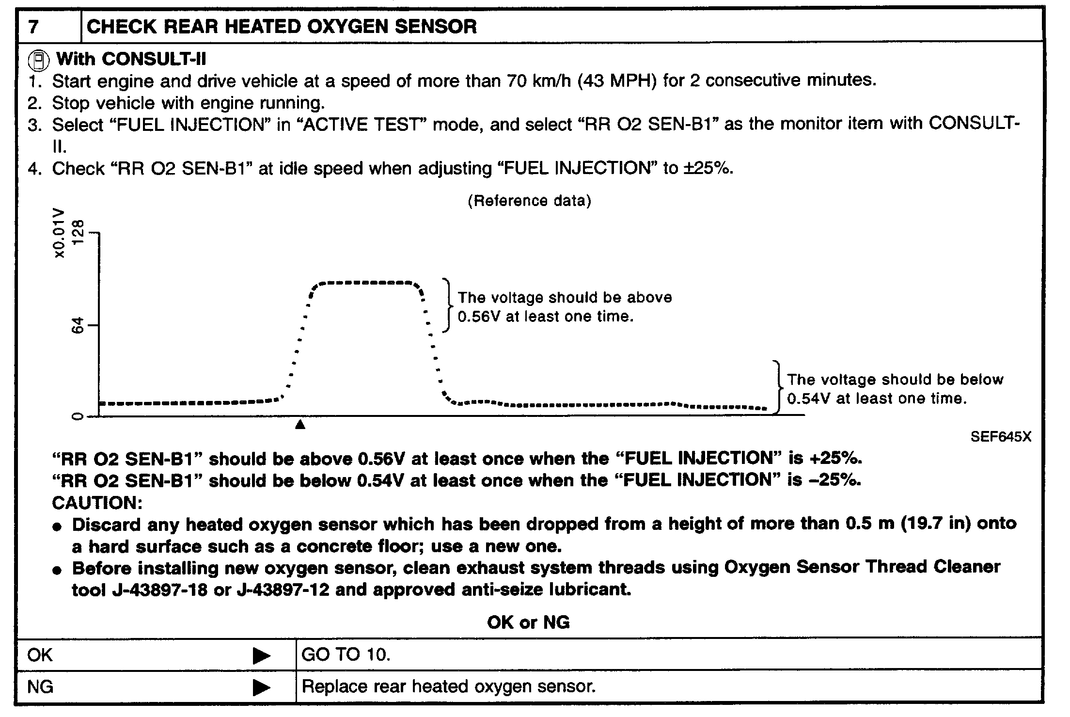

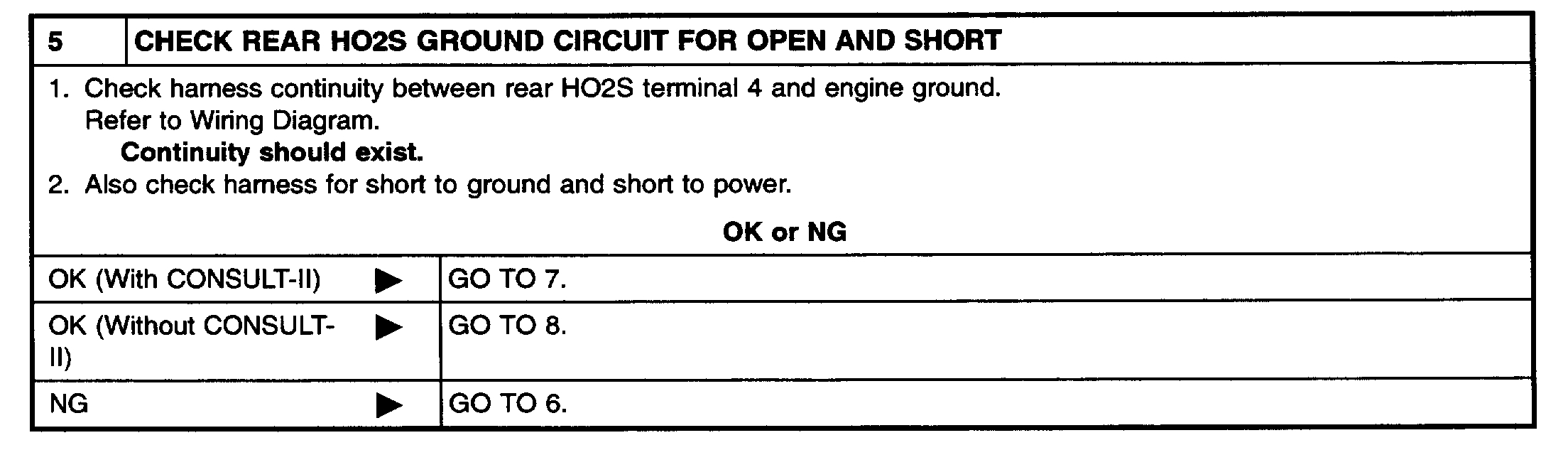

If you look at the attached directions and pics, I provided the diagnostics for this issue. To determine the cause, this is what will need performed.
___________________________________
Diagnostic Procedure
Diagnostic Procedure Step 1
pic 1
Diagnostic Procedure Step 2
pic 2
Diagnostic Procedure Step 3
pic 3
Diagnostic Procedure Step 4
pic 4
Diagnostic Procedure Step 5
pic 5
Diagnostic Procedure Step 6
pic 6
Diagnostic Procedure Step 7
pic 7
Diagnostic Procedure Step 8
pic 8
Diagnostic Procedure Step 9
pic 9
Diagnostic Procedure Step 10
pic 10
Diagnostic Procedure Step 11
pic 11

Nissan have just resolved this fault. It turned out to be the Swirl Control Valve which was defective. They left it disconnected and the car is fine now.
