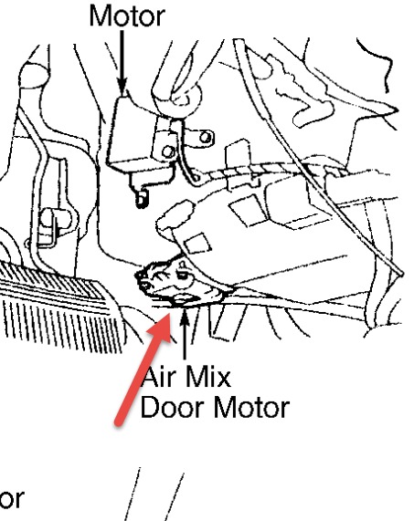

When the climate control is turned on the AC compressor engages and never turns off. This causes me to get cold air unless I set the control to maximum temp of 85 degrees. The air then blows hot but the compressor is still on. I think my water pump may be leaking but that is probably a seperate issue.

Start engine. Within 10 seconds of turning ignition on, press and hold A/C-heater control panel OFF switch button. Hold OFF switch button for at least 5 seconds. Select desired self-diagnosis step by rotating temperature dial clockwise or counterclockwise. To advance to next self-diagnosis step, rotate dial clockwise. To return to previous self-diagnosis step, rotate dial counterclockwise. To access AUXILIARY MECHANISM: TEMPERATURE SETTING TRIMMER, select SELF-DIAGNOSIS STEP 5 and press fan up arrow switch. Auxiliary mechanism tests temperature setting trimmer. This guide can help https://www.2carpros.com/articles/car-heater-not-working
https://www.2carpros.com/forum/automotive_pictures/99387_Graphic1_562.jpg

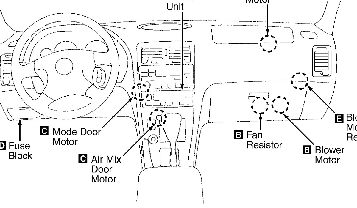

check coolant level first #1 cause of no heat. then check to make sure both hoses going into heater are hot. then check ducts and whether temp cable hasn't broken see pic if electrically operated make sure it's getting power to motor.

No matter what setting the controller is set on, (ac or heat), when the dial for increasing the speed of the fan on the heat or air, which goes from 1-5, is turned, nothing happens. Is this a fan switch or relay? Or is it the fan motor itself? Or could it be the controller? Fuses have already been elliminated.

If fan motor does not work at maximum speed with fuses good, the most likely cause would be the blower fan motor.
Give the blower motor housing some banging and check if it starts working.
Test the blower motor connectors for battery voltage and use external power source to test if it works.
