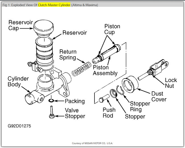

where do you add fluid for the hydraulic clutch?

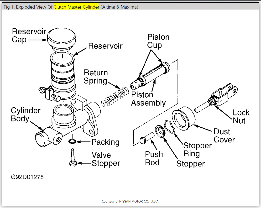

its either from the master cylinder or there will be a reservoir right beside it and it takes brake fluid.
