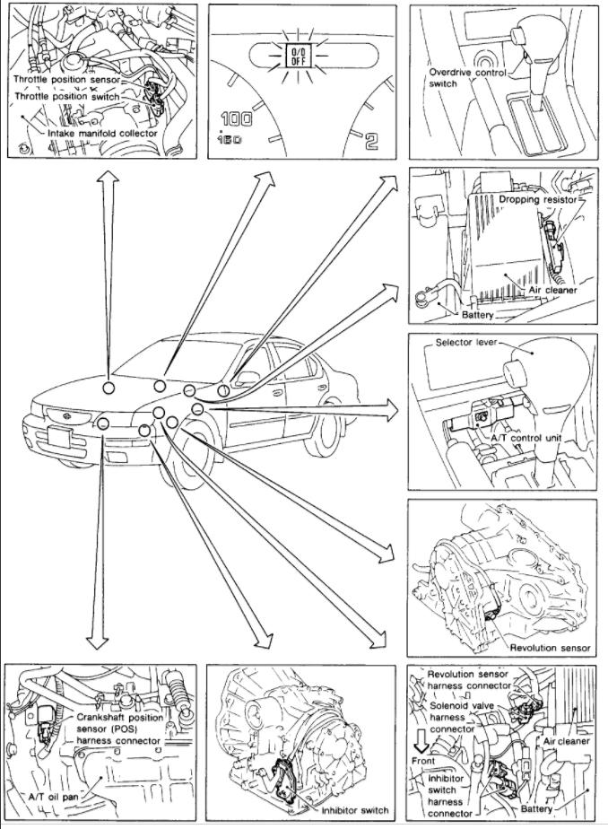

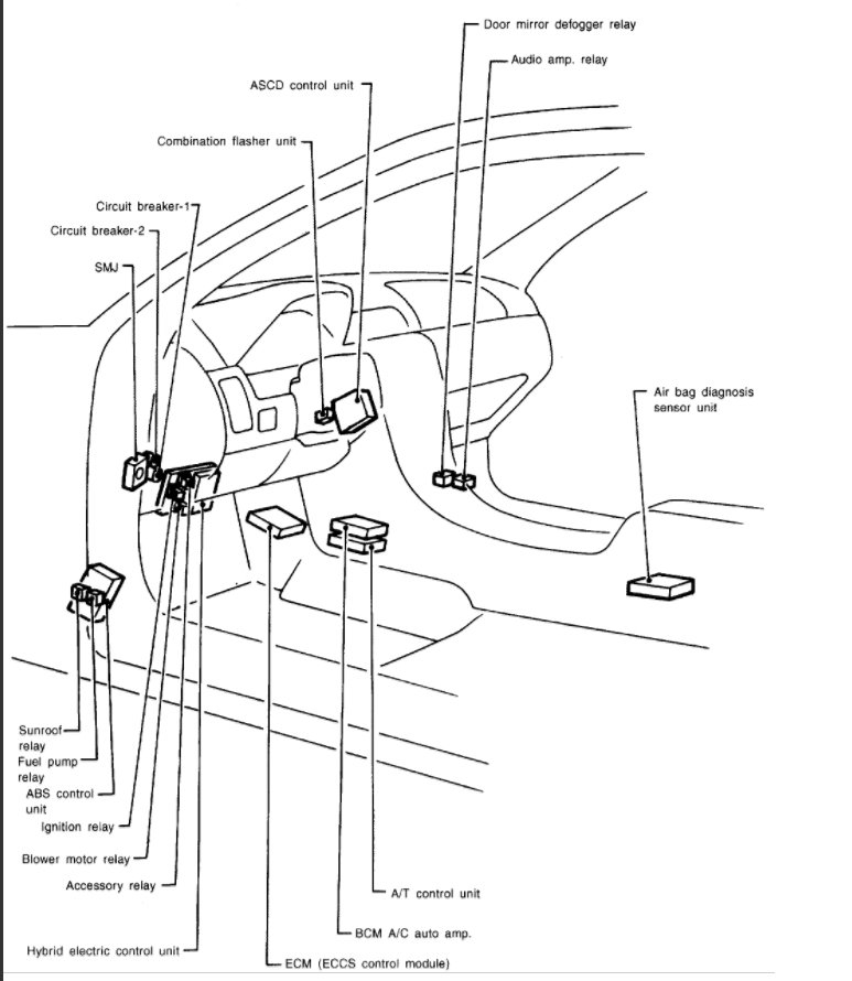

The transmission control module is located in the center console up by the dash. Here are some diagrams so you can see what I am talking about.
Check out (below)
