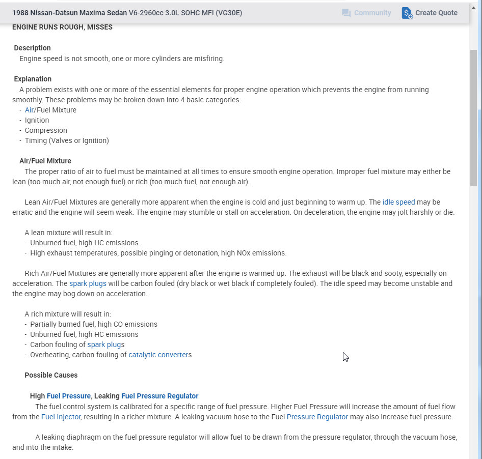

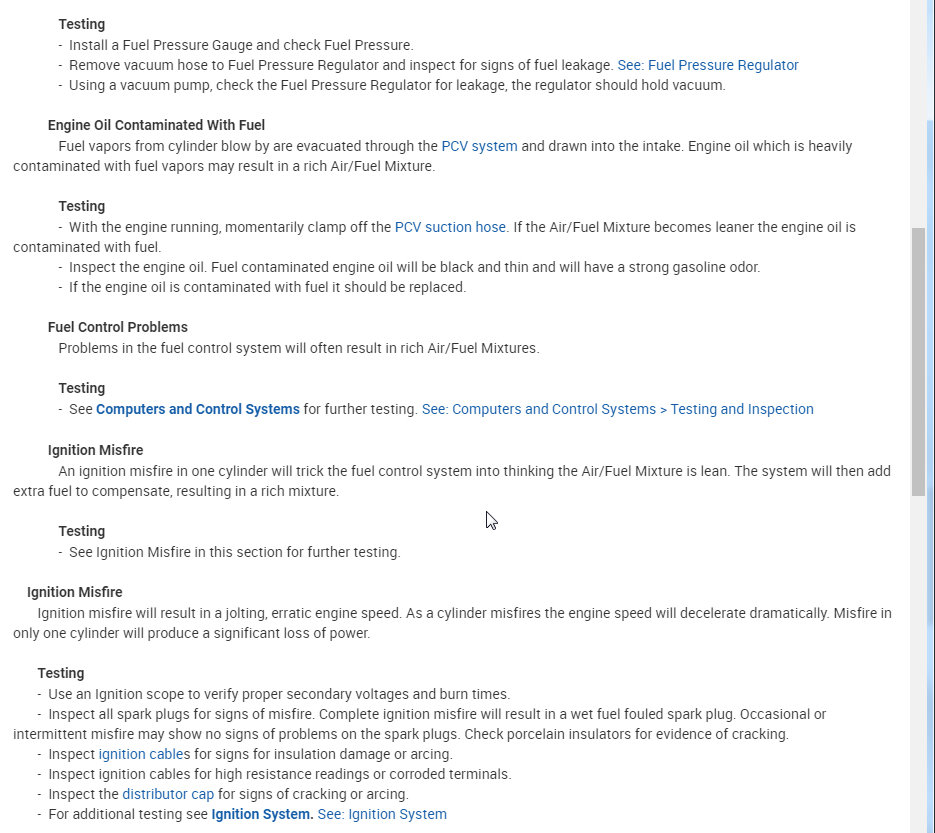

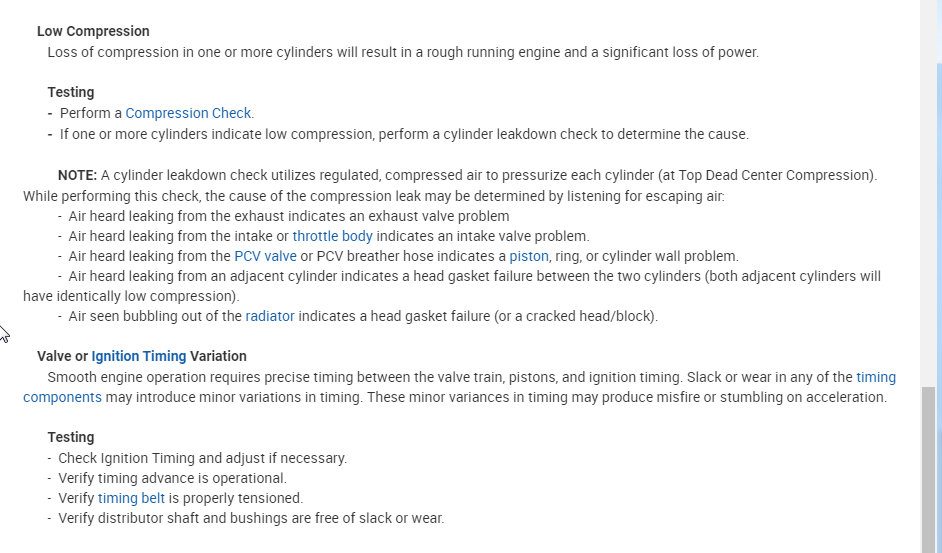

I have attached guides for each of these items. We need to run through this and report back. Also, I attached testing that covers similar items. We need to start crossing these off the list and then we will be able to narrow down what the issue is.
https://www.2carpros.com/articles/engine-misfires-or-runs-rough
