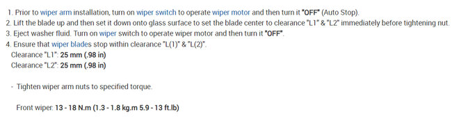

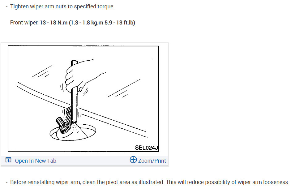

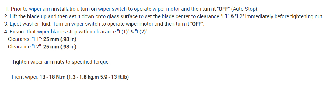

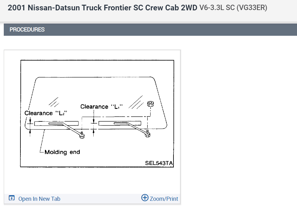

It is best to use a battery terminal puller so you don't damage the threads or the wiper arm, here is the instructions on how to change the wiper arms out. Check out the images (below). Let us know if you need anything else.
