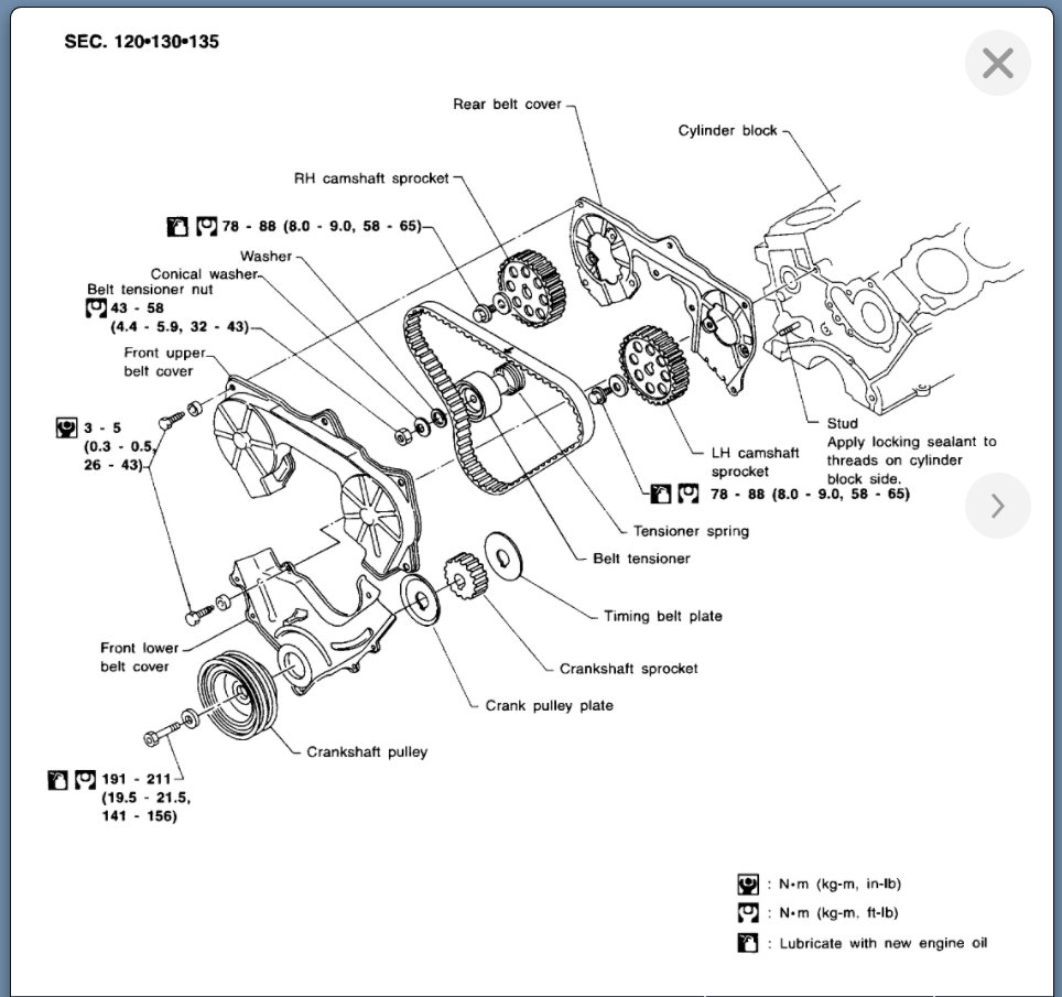

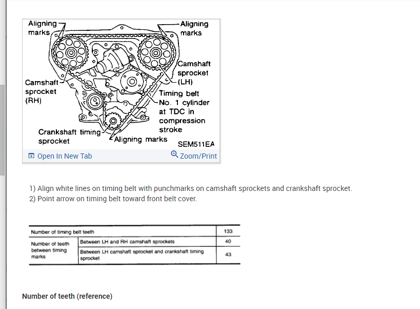

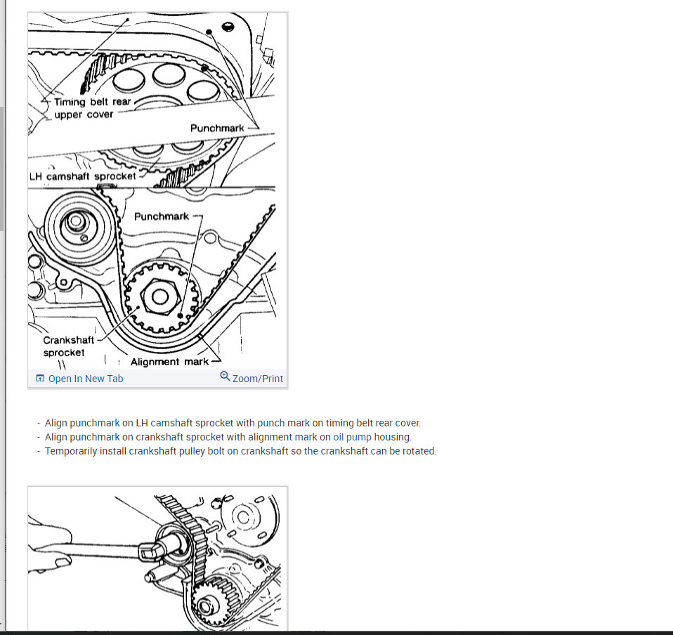

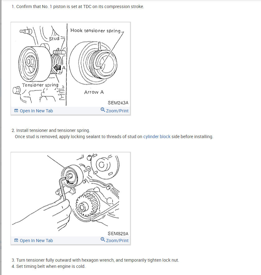

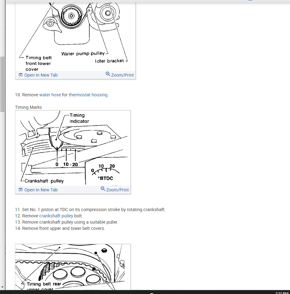

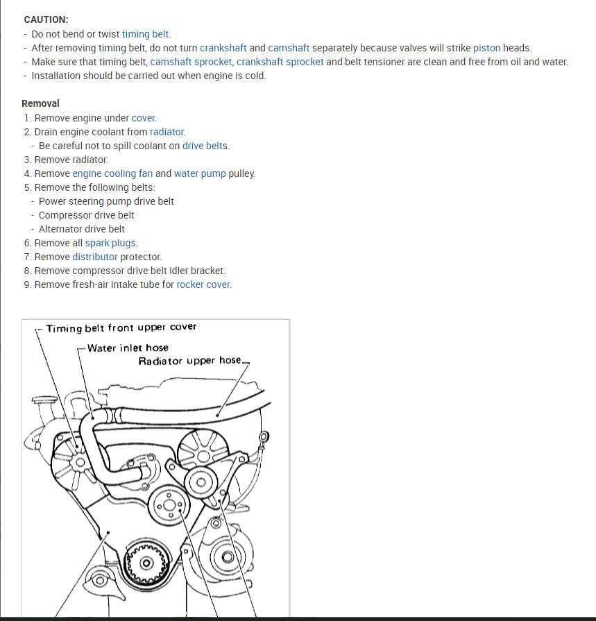

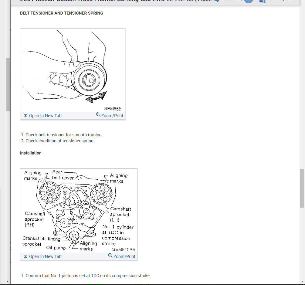

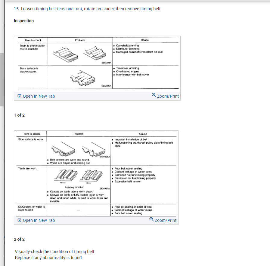

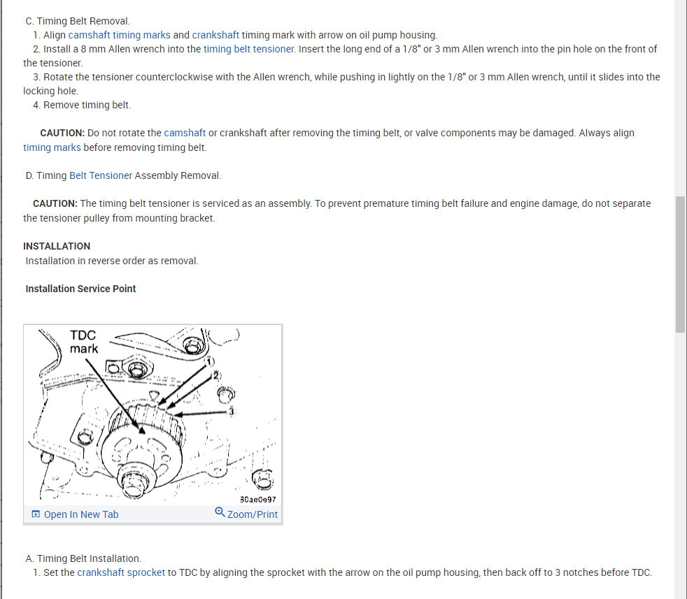

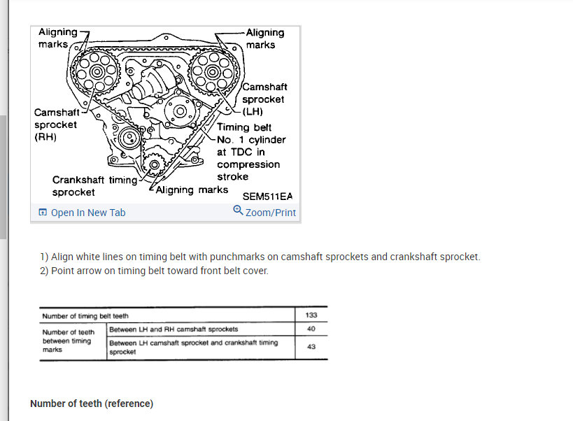

This means we need to inspect the tensioner.
I am attaching the info below on this. Please run through this and let us know what you find.
