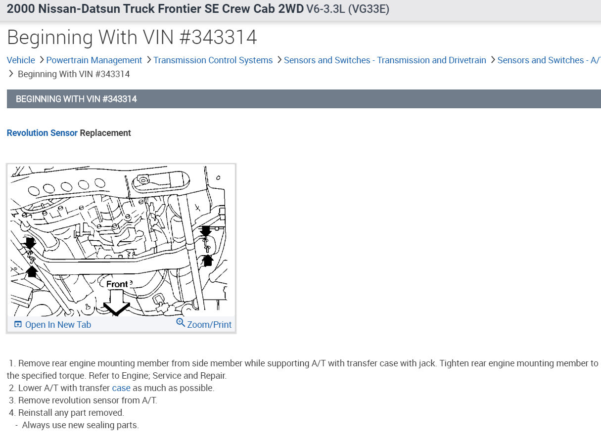

Hey Danny, I happen to have the same exact problem with my truck which is the same exact truck as yours. They replaced the revolution sensor and that fixed it. Check out the diagrams (Below).
