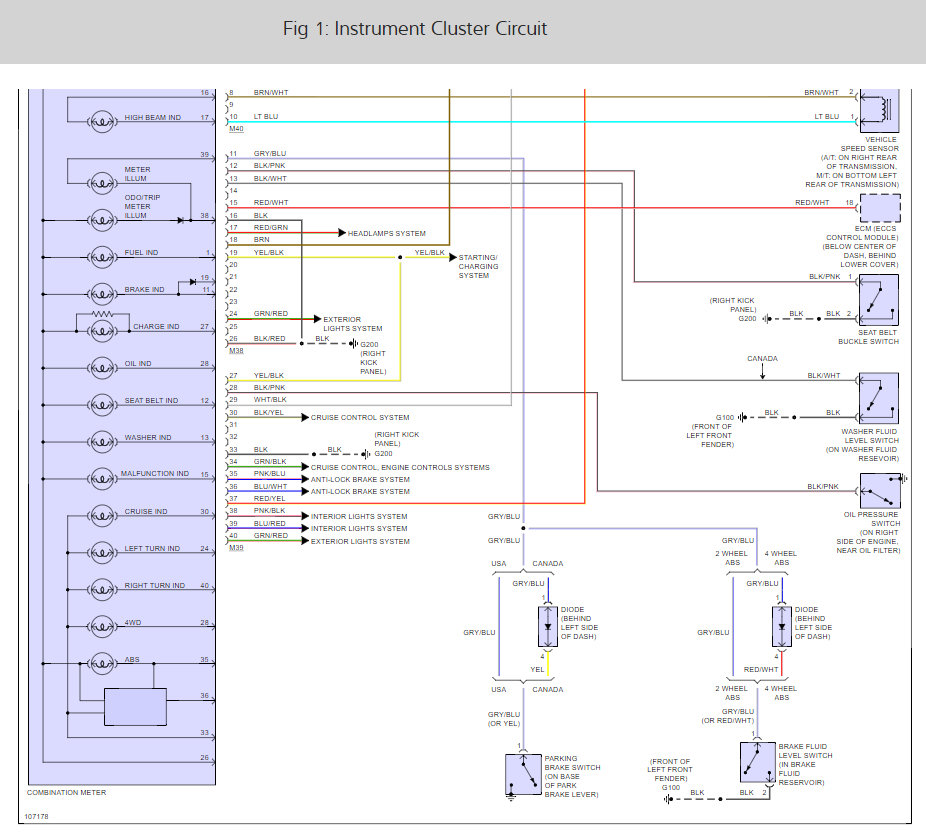

See diagram
https://www.2carpros.com/forum/automotive_pictures/452729_Fontier_Speed_Sensor_Troubleshooting_1.jpg

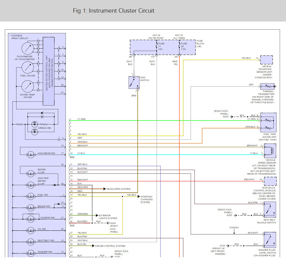

It sounds like you have a vehicle speed sensor that is going out though I have seen bad connections do this as well. Remove the cluster and unplug it. Then plug it back in again. This will clean the connections helps the cluster work again. Here are some wiring diagrams so you can see how the circuit works.
Use the guide to check the wiring
and this to test the fuses

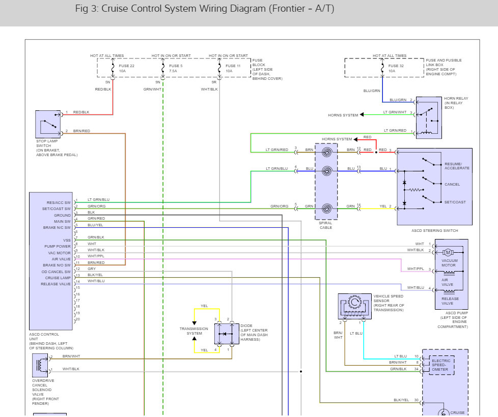

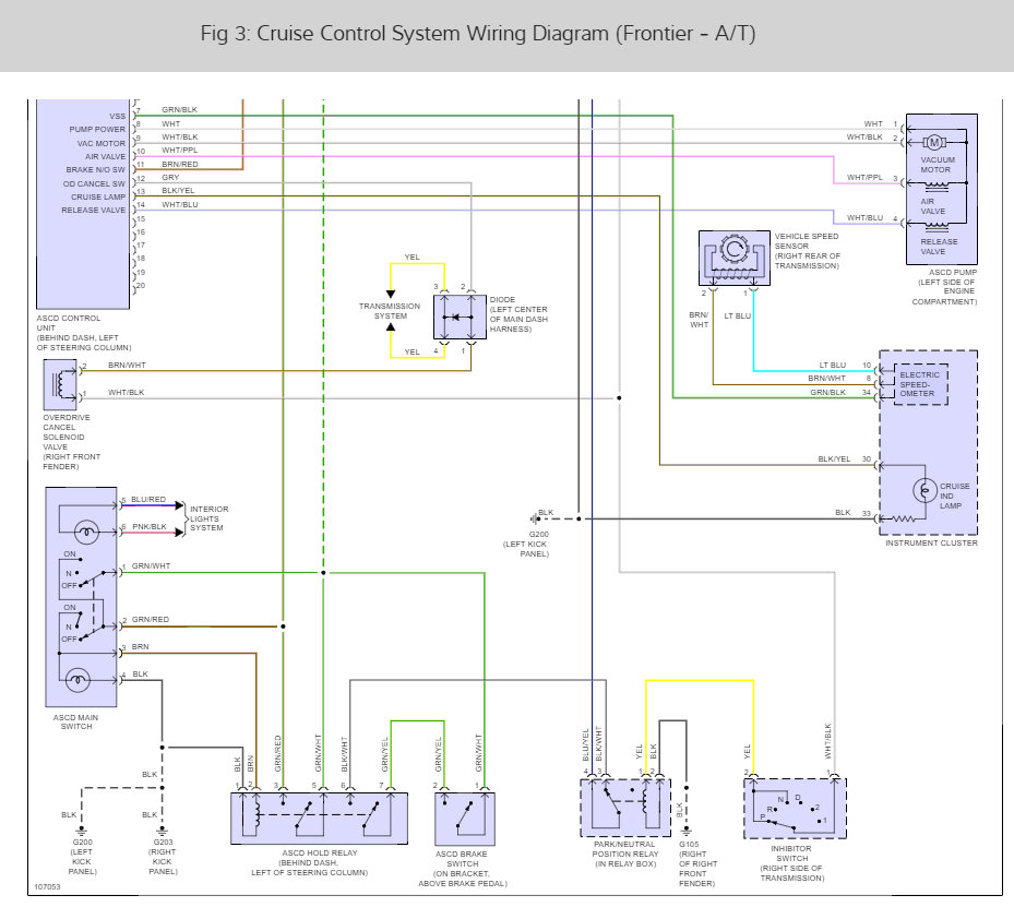

my speedometer quit suddenly and now the cruise control doesnt work
Nov 10, 2017 at 7:29 PM (Merged)
RASMATAZ
  • 75,992 POSTS
Get the vehicle speed sensor tested
