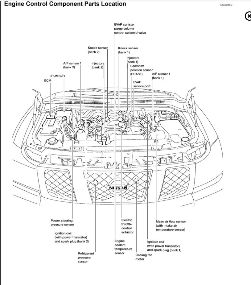

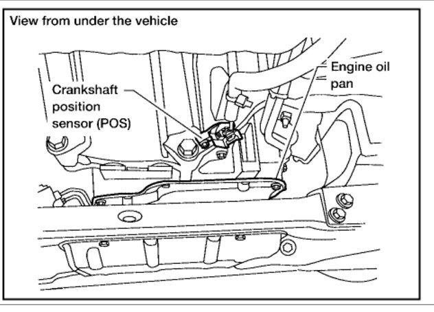

It sounds like you have a classic crankshaft angle sensor that is going out. Here is a guide to show you what you are in for when changing the sensor and a diagram (below) of how to change the sensor on your car.

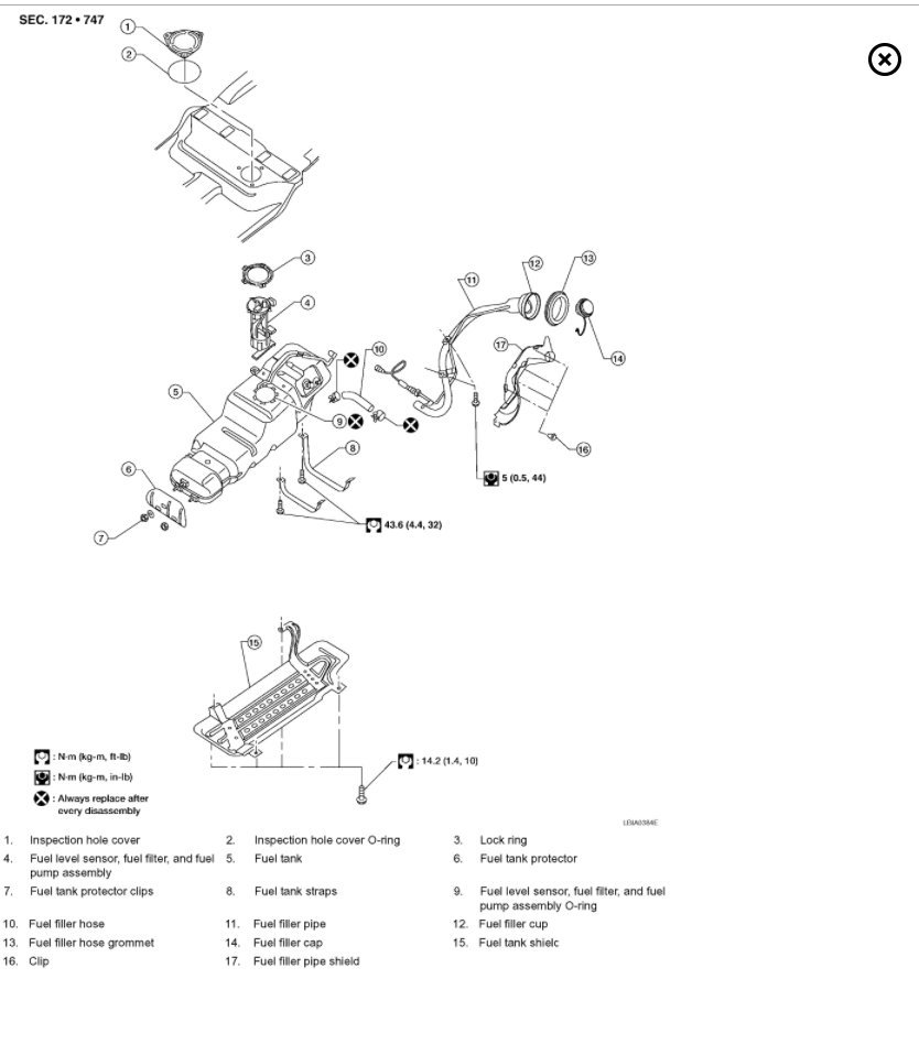

Here is a guide that will show you what you are in for when replacing the fuel pump
Here is a diagram (below) on what it will be like on your car
