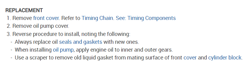

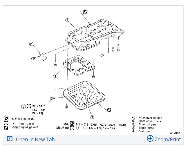

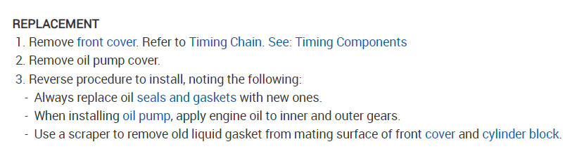

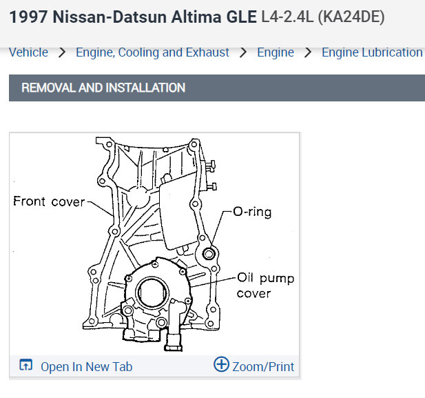

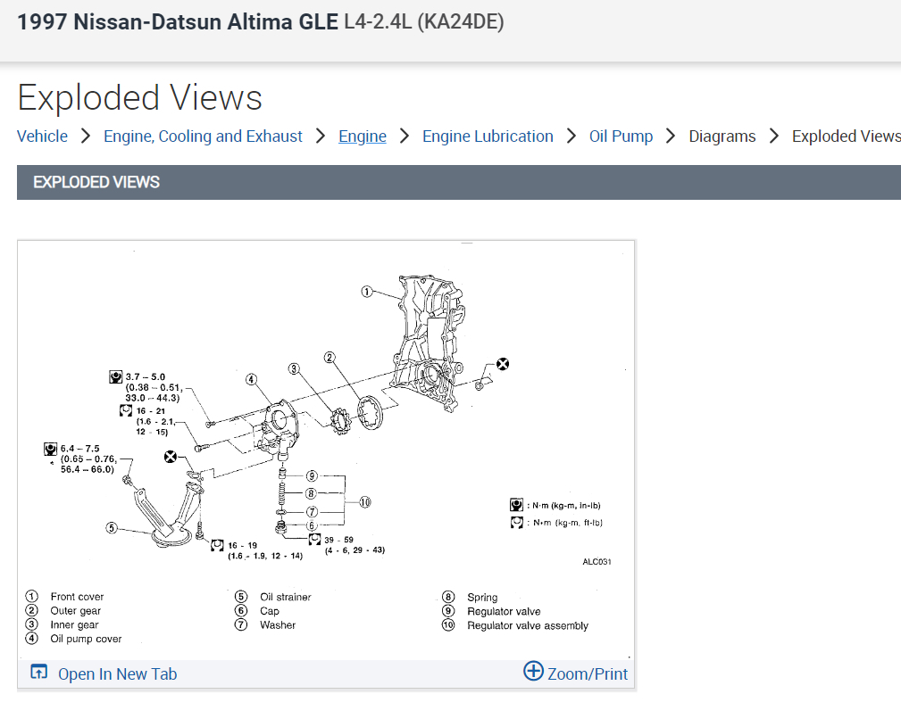

The oil pump is behind the front timing cover and you will need to remove the oil pan as well, here are the instructions to do so in the images below. Also make sure you clean the oil pan from deburis. Use new gaskets when you reassemble. Check out the images (below). Let us know if you need anything else.
