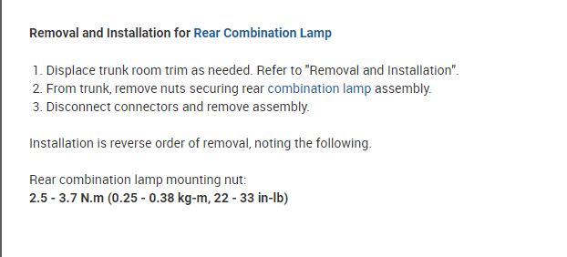

Below is the process from the manual on how to remove it. This is not that detailed but once these nuts are exposed, the process will not be that complicated.
Please run through this process and let us know if you have other questions.
