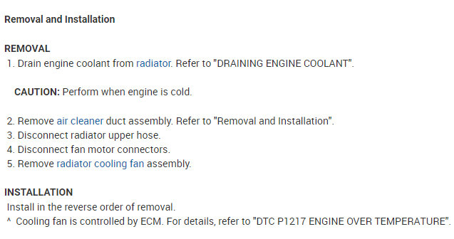

how I do change the radiator fan? thanks a lot.

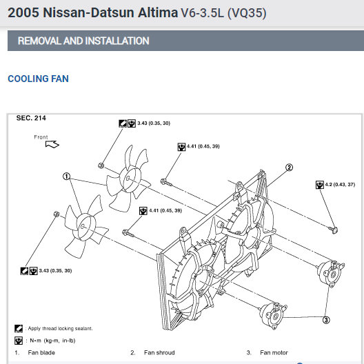

Hello, I'm Danny.
Here is a tutorial showing how the cooling fans work:
https://www.2carpros.com/articles/replace-electric-fan-motor
I've attached picture steps below on how to remove and replace the cooling fan assembly for your car. Hope this helps and thanks for using 2CarPros.
Feb 19, 2021 at 1:17 PM
